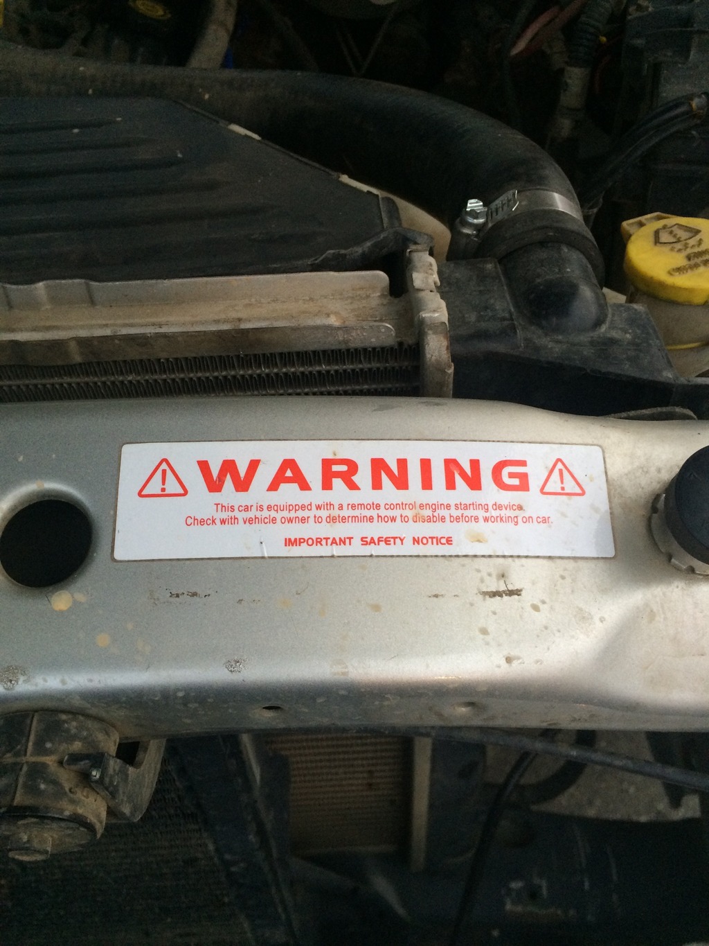

anyways, heres the sticker on my rad support. What do you think? definitely not factory is it?

Thanks for all the help guys, DF rocks!!! So due to my worn out remote I really didn't know what I had, thanks to the kind folks at DF i have figured out I have a compustar pro G8 system installed w/ remote start feature (figured out it does work, but the remote has to be within a foot or two of the module). Obviously I have a signal issue and now i need to figure out why. I was assuming my truck came from factory with RKE, but I guess I was wrong. Anyways, I've sent off an email to compustar support and hopefully they can help me troubleshoot, and get some parts, thanks again guys.
