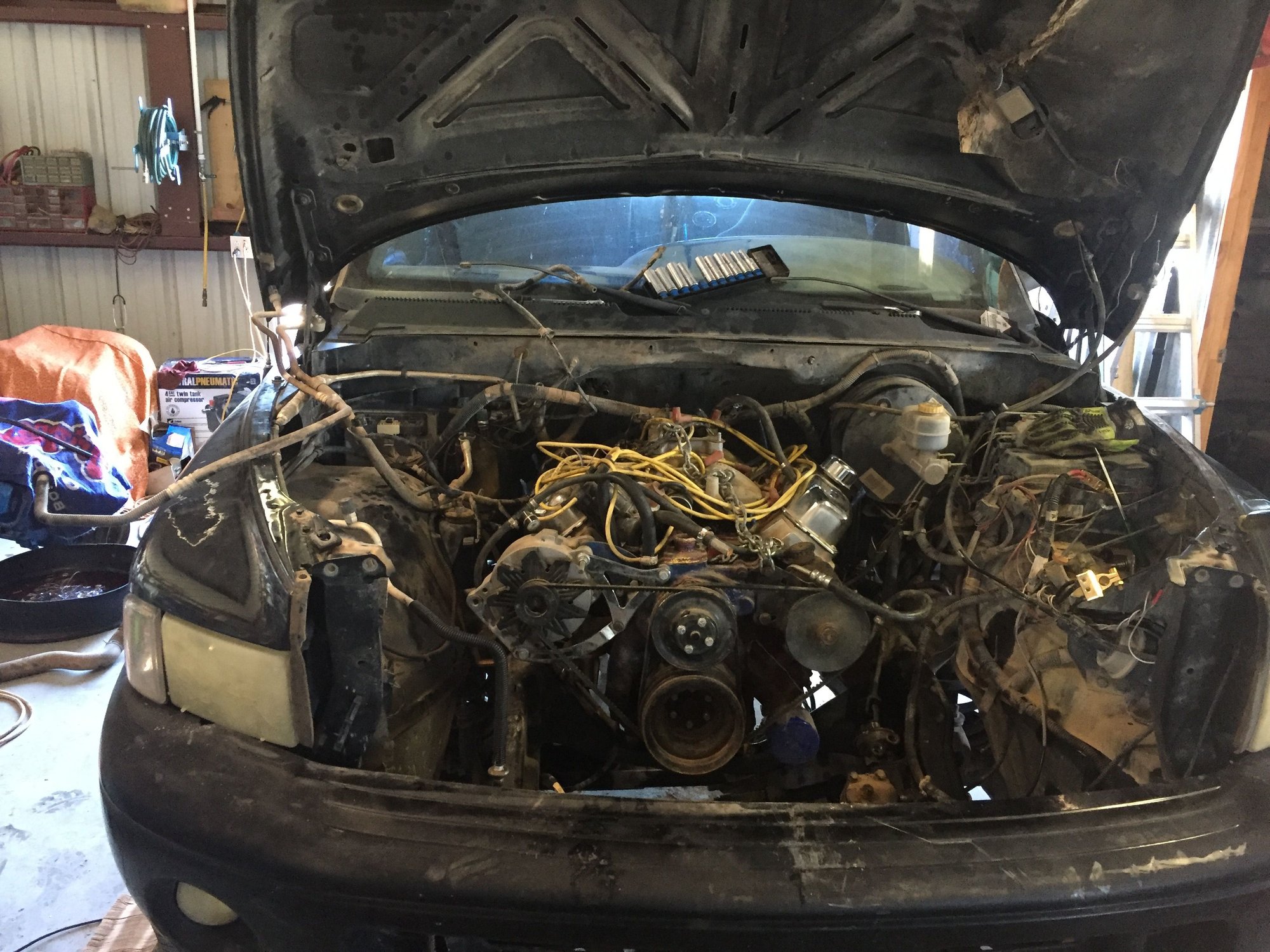

In the mean time here are some pictures of the engine

The central timer module sends data to the cluster on what basically amounts to a network connection. (CCD bus.....) I have no idea how the data is sent, but, I suspect it works exactly like your computer network, and the data is sent in packets, which the cluster then interprets. I do not think you can synthesize that signal........ Either need to have the PCM hooked up to the sensors it wants, and then feed the cluster, or, switch to custom gauges.
