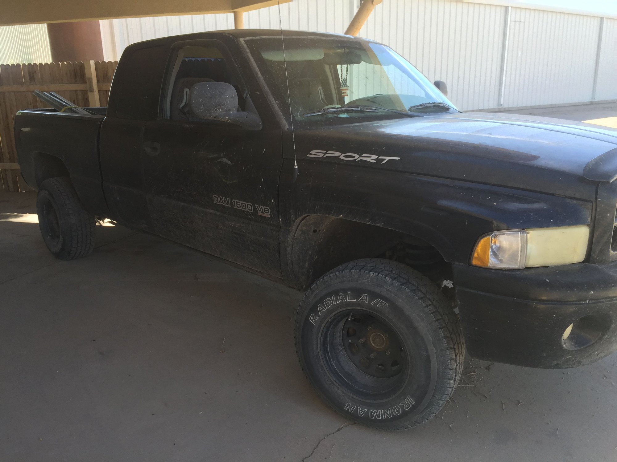

She is a 1998 4wd
Have a built 440 pushing around 480 hp
Tremec T-56 trans
Divorced transfer case to keep 4wd

That's gonna be fun.... In more than one sense of the word..... Chances are good, all of your instruments are driven by the PCM, thru the central timer module. It's entirely possible NONE of your gauges will work with the 440.......
I have been going through and tracing each guage to see what does not go through the pcm. If the cluster doesnt work i was thinking of replacing the individual guage.
Old Dec 12, 2015 | 09:46 PM
Posts: 87,554
Likes: 4,230
I *think* oil pressure is the only one that doesn't go thru the PCM. (PCM really doesn't care about oil pressure..... which I find kinda odd.....) Everything else pretty much goes thru the CTM. Do you have a copy of the service manual yet? If not, grab one here.
