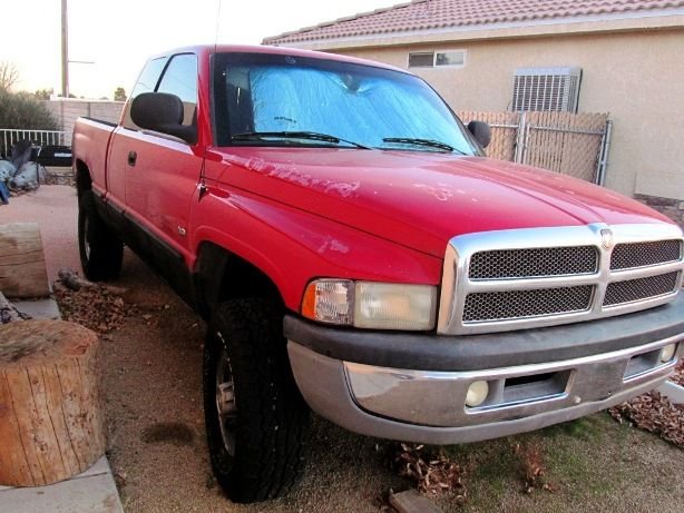

1998 1500 4x4 130k miles. Locked up 5.2l Lot of new parts.
700.00 USD

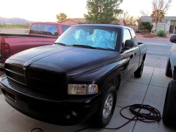

1999 2500 4x4 V-10 Leather interior Owner's kid put a rod through a cylinder wall drag racing it. New computer, exhaust and tires.
700.00 USD

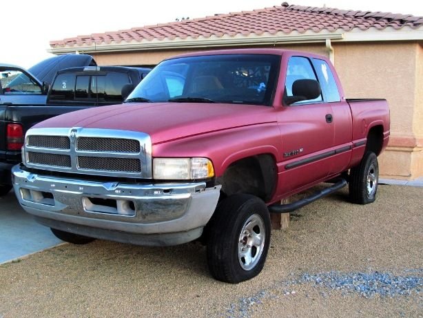

2001 1500 4x2 Sport decent 5.9l 125k miles. Reverse band in tranny broken. Having trouble getting title.
500.00 USD
Who said anything about lovely, pristine, garage kept, unabused trucks? I said decent iron, reasonable price. Sunshine has beaten these trucks a bit, the V-10 has the only good rims and tires. The point is, the price is right, hell, the front clip on the Sport is worth the purchase price alone. If i take what I want from any of these, the remaining parts are worth quite a lot more than what I have into them.
