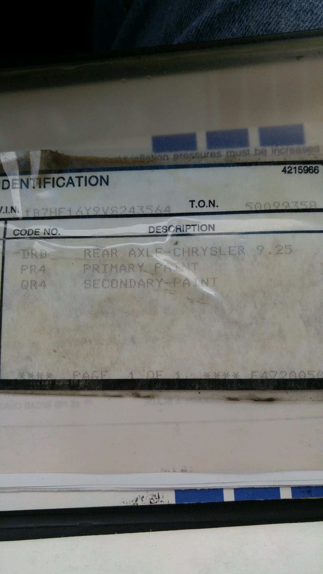

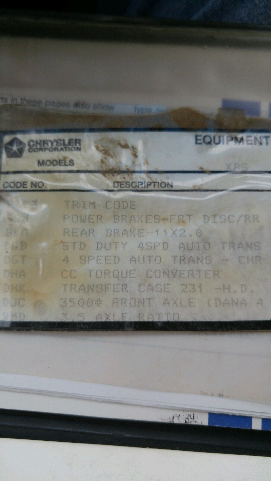

Default How do I tell the gear ratio!
Was told there's a tag on rear end and I've looked everywhere on it and haven't found anything! This papers are all the vehicle info.
Old Feb 25, 2016 | 05:49 PM
94Beater's Avatar
94Beater
Joined: Aug 2007
Posts: 250
From: Phoenix, Arizona
Right there. Bottom of 2nd picture. Axle ratio 3.5
So it is the standard 3.55

It's usually a metal tag under one of the bolts holding the diff cover on.
