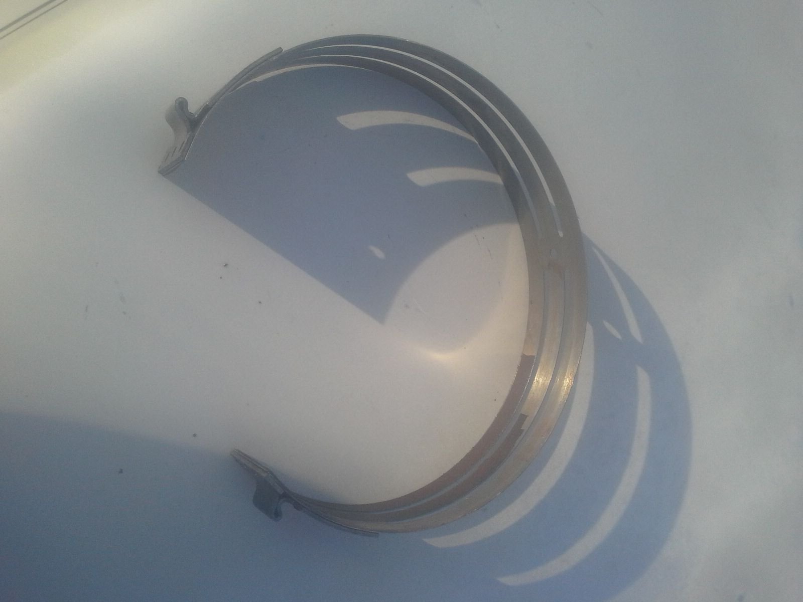

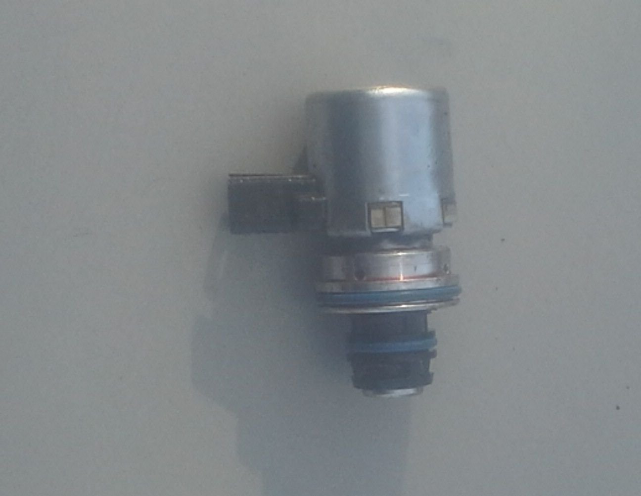

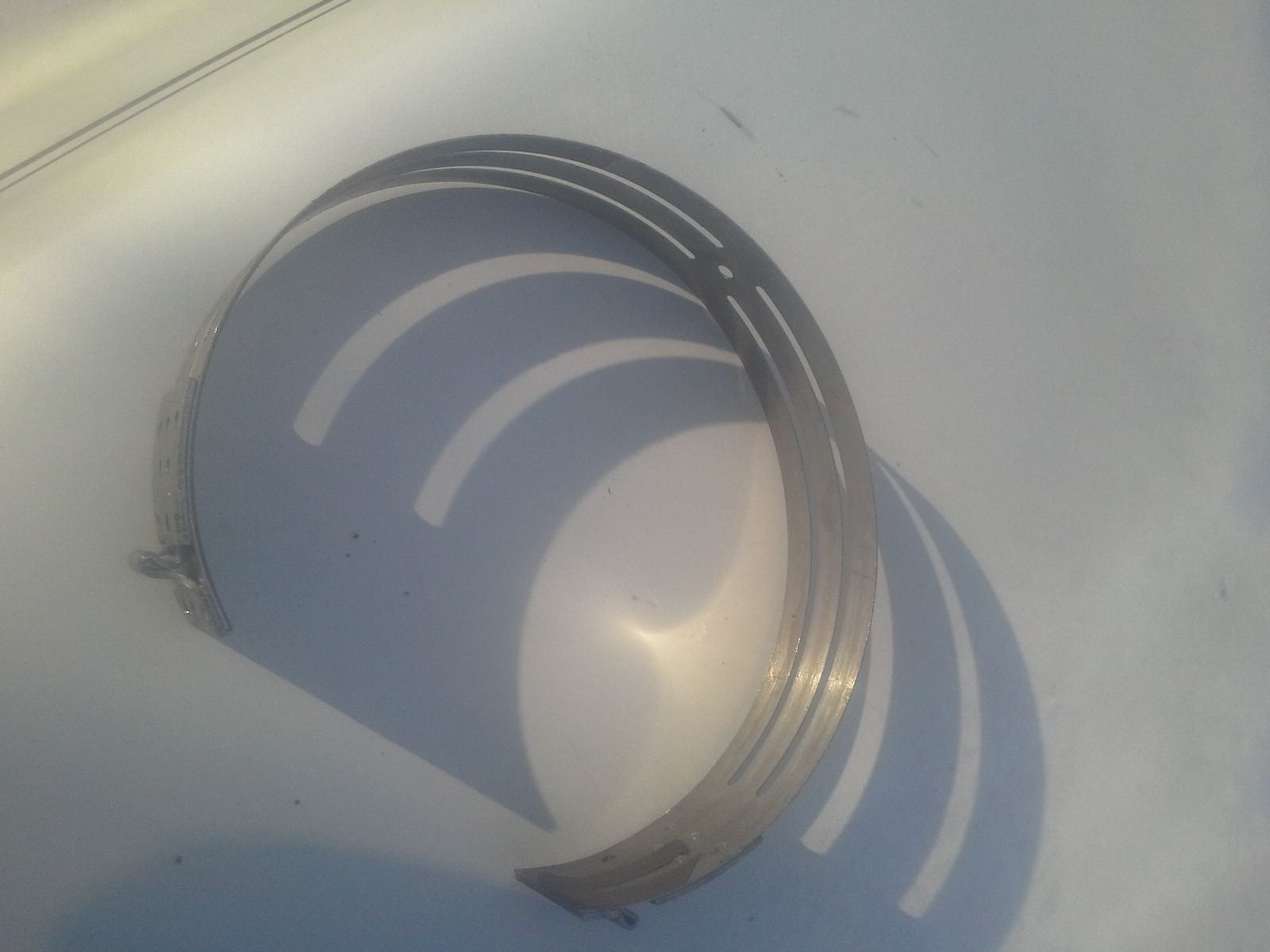

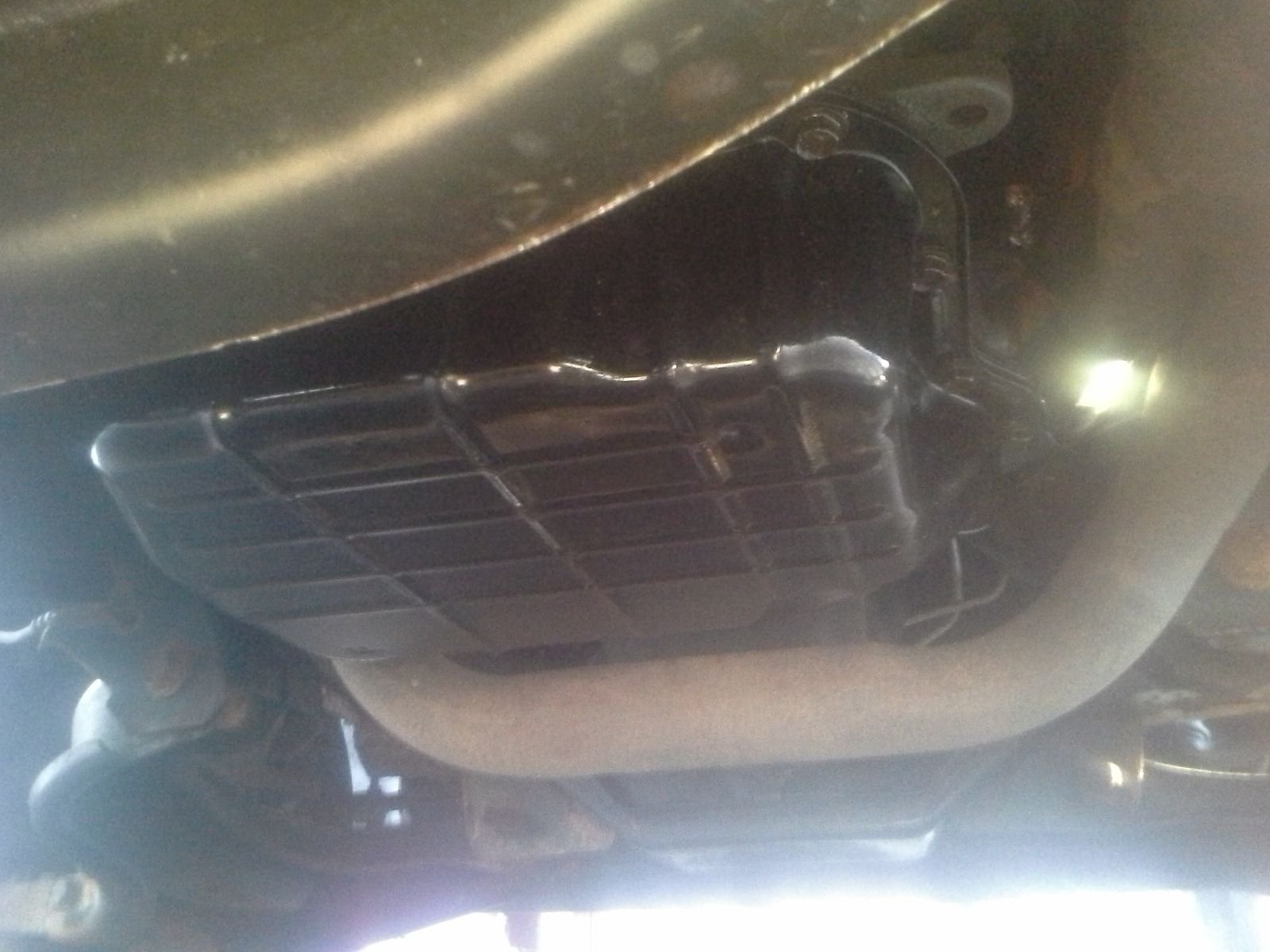

#1. I can take a few pics later today sometime. say of the shredded front band if I find it (scrap metal bin), the carton and old GOV sensor/tranducer pair, and the shelled Main case, and under the truck of the Shiny New Black AT Pan I guess.
#2. Yes
#3. Abso-friggin-lutely
She ain't No street Beast, or lifted Toy, But I am extremely happy this nightmare is over and she is back up to being the reliable, loudmouth, I've known her to Be, actually better than before.
I suspect the Gov had been going for some time because Now You can tell when and where She cut to the next gear + You can make a distinction of whether or not the OD is On or OFF just by the differences in shift RPM unlike before the band blew apart.

Blown Main case and outer Sprag/Reverse support
Commonly broken OEM Front Band Servo Piston & spring retaining collar that breaks off the Pin
Spent Front Band
More Bald Front Band
NEW OEM Gov Carton/ Old Gov and Transducer
Clogged/Bad Gov pressure sensor
New A518/46RE Pan
