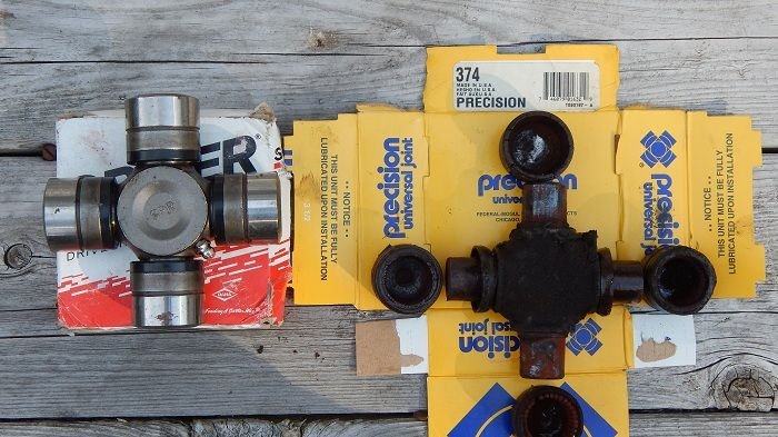

You can grab the axle shaft coming out of the axle and wiggle it to see if it makes the sound
If it does you know it's the u joints

Put a pry bar on the axle shaft and see if you can move the yoke, you shouldn't be able to.
Here's a video of mine when I first heard of how our u-joints sound when their needle bearing turn to dust.
