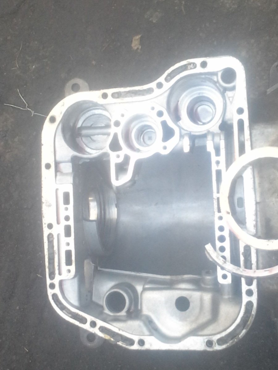

looking at VB opening up, it locks in counterclock. Even if I am remembering wrong, you can't really put the Sprag ( AKA 14 ROLLER ONE WAY overrun clutch) in backwards because there is a mildly fluted edge.
It will not go in at all if the lip is not matching up to the fluted edging where it seats in the back of the main case. My case detonate due to an oversight or failed circlip that holds that planet and annulus fast to the intermediate shaft. Everything I guess walked forward the sprag exploded and rollers wedged were the didn't fit until it locked the sprag support liner hard to the annulus/reverse drum in the case and 'slpoded the case.
Blown Main case and outer Sprag/Reverse support
Commonly broken OEM Front Band Servo Piston & spring retaining collar that breaks off the Pin
