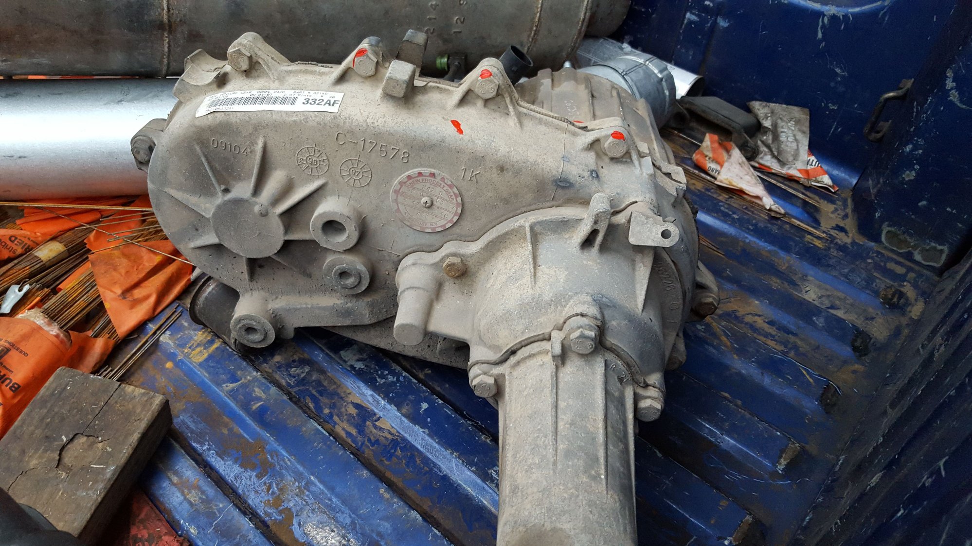

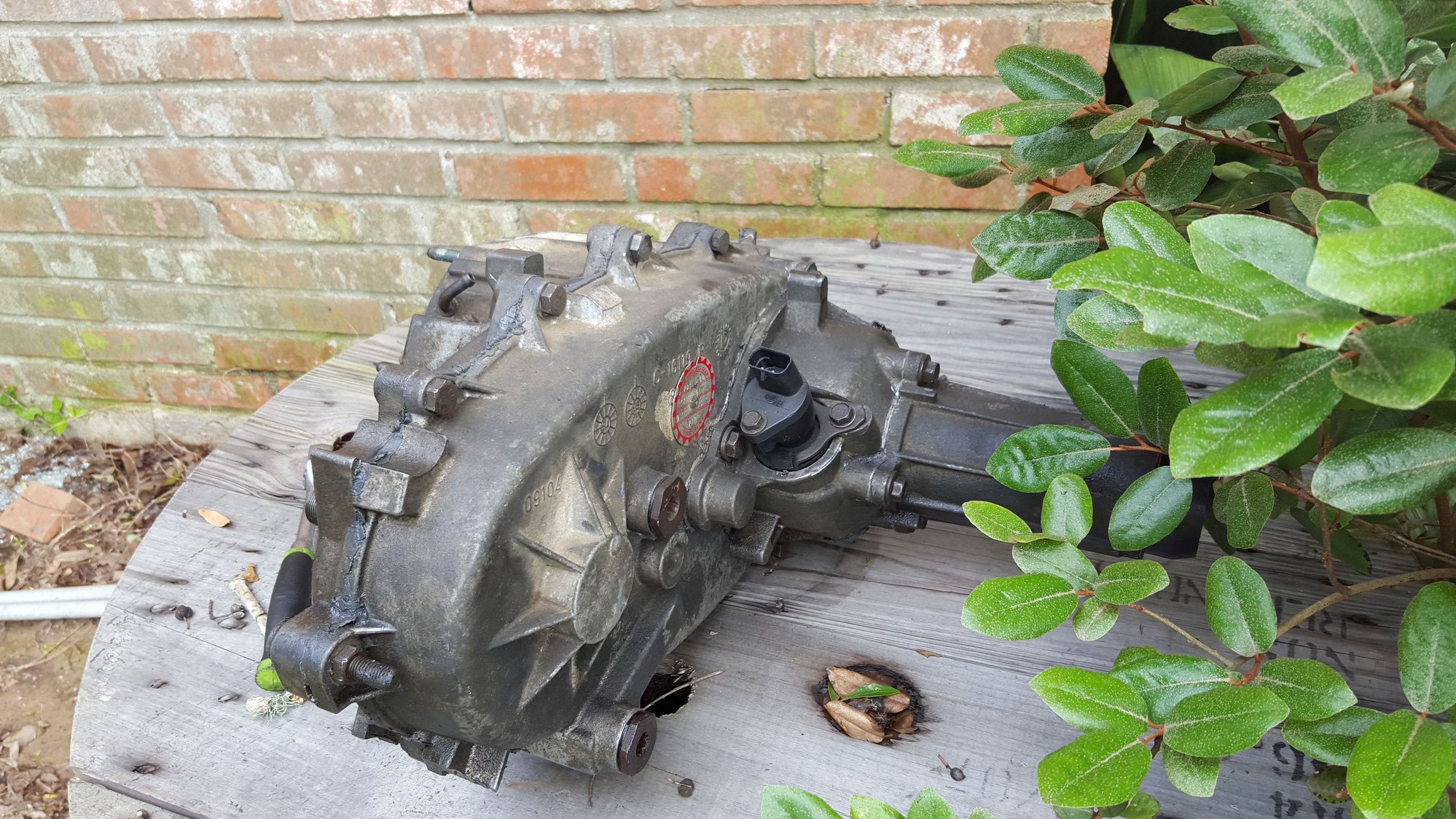

Ok, so like I said, I found the case on a 1999 Durango that had a 5.9 in it. Seemed odd to me because it didn't have any R/T insignia on the side. Also, one thing to consider when doing this swap....being able to use your speedometer. The picture below shows the VSS, the one above is missing this. A slight issue, but I've found a way to use the ABS sensor input.

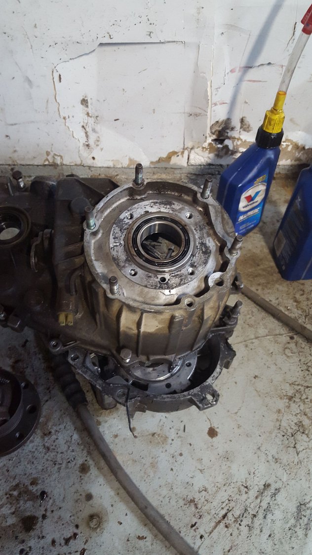

First and foremost, it always a safer bet to swap the input gears so as to eliminate any issues down the road when it comes to installing. The top pic (241) has a longer snout on the input, while the bottom pic (242) has a shorter snout. I'm not all that familiar with why the gears are different sizes, considering one came off a 46re and the other a 47rh.
To get to either input gear, you're going to need a 15MM to unbolt the two halves and the two piece tailhousing on the 242. The 241 will require the same, except on the tailhousing, those require a 14MM. Oh and make sure you have a set of lock ring pliers on hand. LOCK RING, NOT SNAP RING. I cannot stress that enough as both cases, if not all of them have a retaining ring inside the tailhousing.

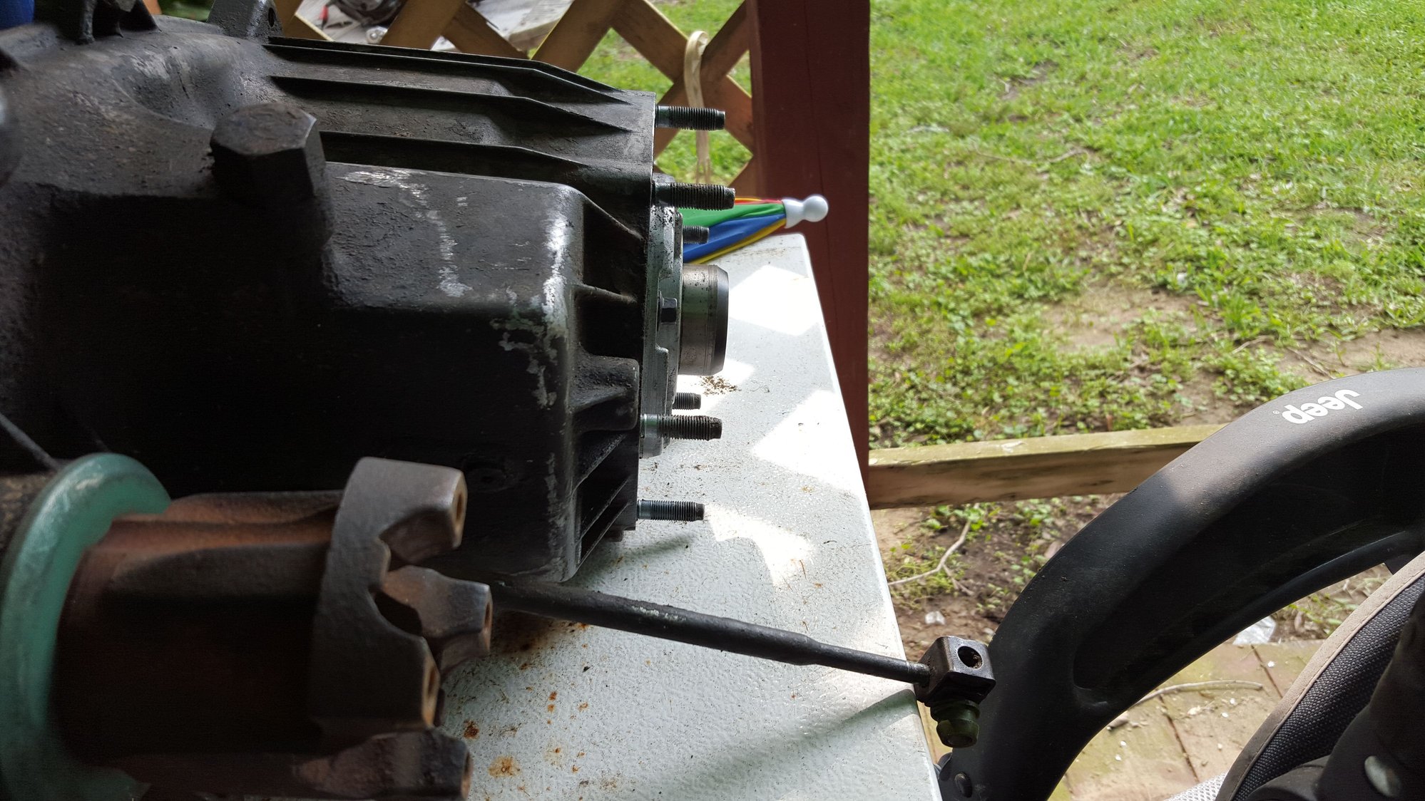

After removing the lock ring on the sprockets for each case, I removed the main shafts as well. What takes 30 seconds on the 241, took me an hour for the 242 due to the tight fitting and lack of play. Once that's out, we move on to the front of the case where the input gear is.
The cover that goes here has four 10MM bolts. Inside that cover is another lock ring that holds the input gear and planetary assembly. Remove that and it will fall out.
242 on the left with 3 planets and 241 on the right with 6 planets.
