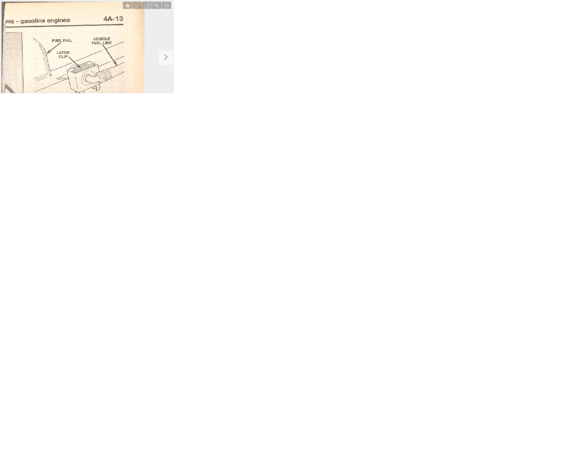

this is the type of connection i have
Old May 20, 2016 | 08:20 PM
Posts: 87,479
I think that was a 97 only design, to change over, may have to change the connector there as well. (which I think you can get at the parts store, in the 'help' section.)

Take a real pic of the connection if you can.
