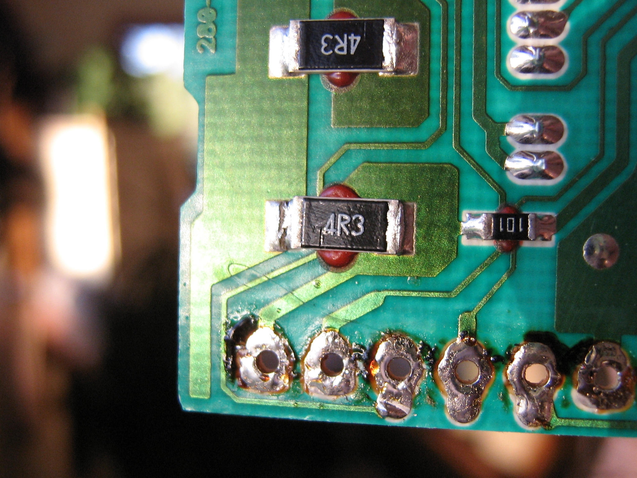

Those green tube displays always look like there is a burn mark on them. Pull the unit and check for power to it, with the ignition on. Then look for a bad surface mount resistor as shown below. It is from my 07 Tacoma but it also happened to my 03 Jeep. See the thing labeled "4R3" that is the resistor. If you look at the left mounting solder joint, you will note the crack. If you just touch it up with a warm soldering iron and a dab of solder, it should fix you. Of course, it couldn't hurt to touch all of the solder joints up too, while you are in there.

That "burn" spot is, indeed, normal. You may want to double-check those connections with a magnifying glass. Honestly, just for grins, I would hit all of the flat surface mount resistors with a hot soldering iron.
You could also try to follow the trace on the PC board that supplies power from the connector. See where it goes and which components are in its path, then check them for opens or shorts. The thing with the heat sink (thing with yellow dot on left of pic) is a voltage regulator. It changes the voltage from 12 to 5 and/or something else. Carefully, check each pin to ground with ignition on. At least one pin should have +12 and at least one is ground. The others should have something on them. Tell us what they are.
