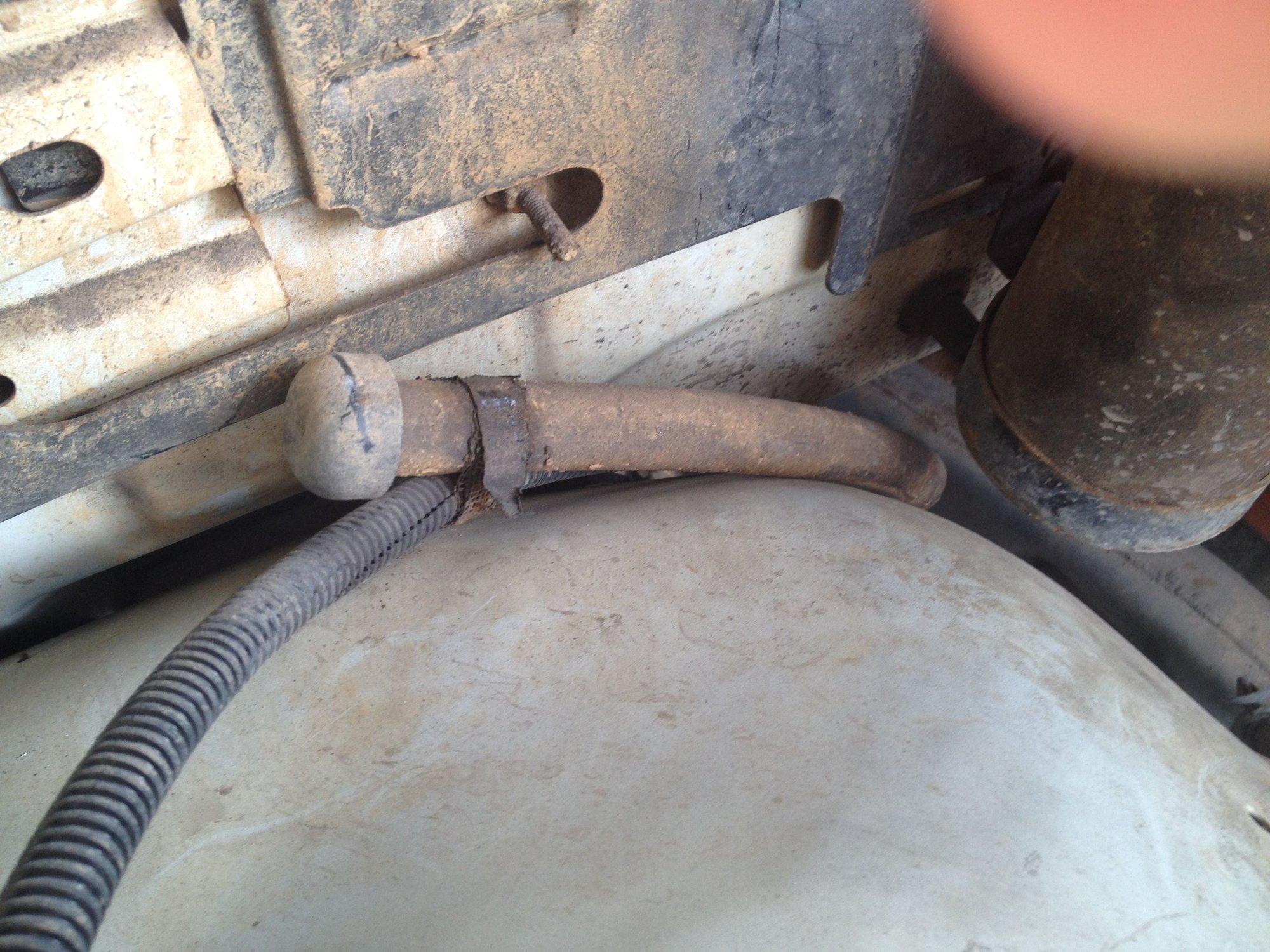

I have a 1999 Dodge Ram 5.2 4x4. I'm getting that code and can't seem to find the leak detection pump. Looks as if it were removed to tell you the truth. If I were removed would it throw a code? I've ha the truck for months and this is the first time I'm seeing the code. Just recently got a new ecm for the truck so I don't think it's the issue.

I think the ldp is supposed to be there.

And a hose that I think is supposed to run to it is closed off.

That hose with the "plug" in it is a breather line. And it's not a plug.
Old Jun 22, 2016 | 04:49 PM
Posts: 87,556
Likes: 4,230
I think the hose is the front axle vent hose. If it goes down to the cad on the front axle, that's what it is, and it is correct.
Yeah, it sure does look like its missing..... I think. (my truck didn't come with one from the factory.)
Ok. Looking in the 98 service manual, page 25-16, it has a nice pic of where everything should be, and you are missing most of it. If you don't have the 98 manual yet, grab one from here.
My truck is a 99. The hose that's closed off runs to the little canisters close to the gas tank. I can remember the prober name for them. But it's not the front axle breather hose. I found the front axle breather hose. it runs elsewhere.
Old Jun 22, 2016 | 05:15 PM
Posts: 87,556
Likes: 4,230
Ah, then that likely did go the the pump.... which is no longer there.....
