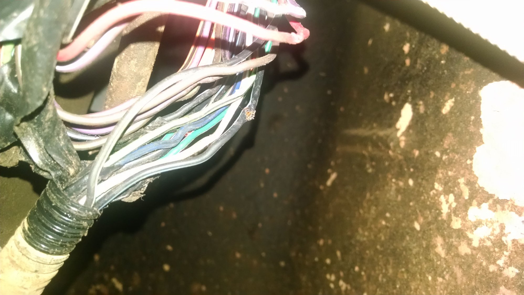

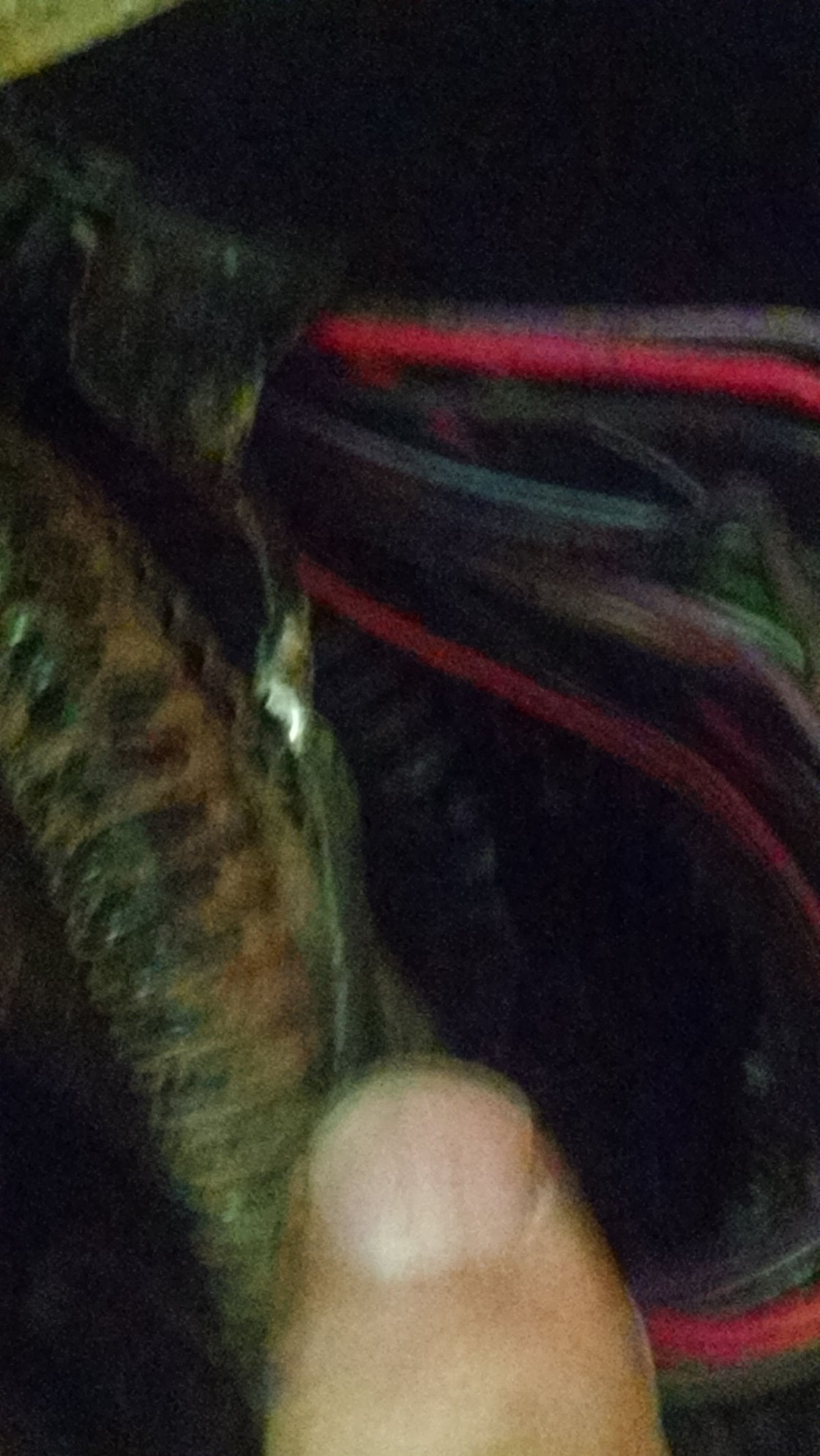

Sory it has taken me so long to get back. But ive been chasing wires. I got to tranny and found a harness that looked to have fairly new tape in it.. I took tape off to investagate and found , sometime down the line a mouse or somerhing had chewed wires bt shift linkage. So some jack leg decides to solder 1 black wire and instead of heat shrink he uses tape.. Well he fails to notice the other 3 black /white , purple/white, red/white wires that have knicks in them . I got them crimped tpgether now bit what is best way to repair? Solder and heat shrink. Im gonna include a pic.I drove trick today seemd fine do you think this could be problem? Thanks again guys

If those wires were shorting, they most certainly could be causing some interesting issues. Would certainly confuse the PCM.... (one would think it would set codes, and such, as well....)
For nicks in the wires, that don't have too many broken strands, I just hit them individually with liquid electric tape, let them dry, the wrap individually with tape, and then the whole harness. Never had one come back on me.

thanks will do.. It would happen ;ole if o was going down bumpy road. I just figured they were shorting out ground.. Ill do that and see what happens, thanks
