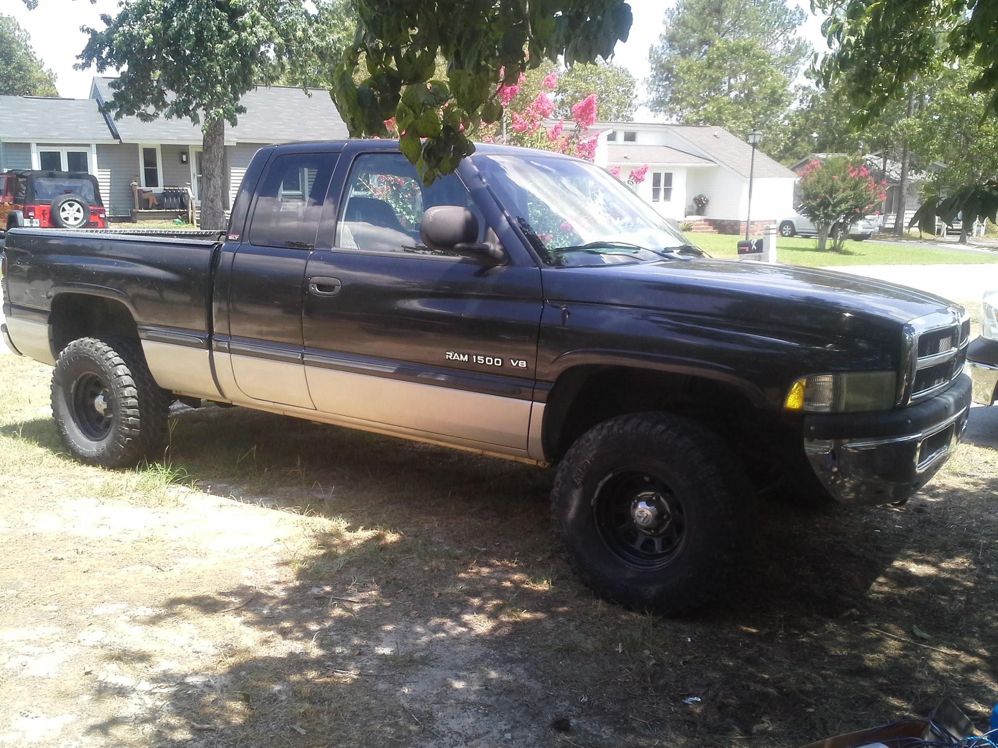

This is the truck. Theres nothing at all wrong w inside. Dash is like newish, no cracks or fade. Seats are great. Its the one that has pwr seats, locks, tilt, cruise and stuff. I do hate that theres no slider in back window! Spray on liner and heck of a tow package w aftermarket elec brakes.
Is the after elec brakes why the obd2 port wont turn on the code reader and that the radio wont play(does light up/just no sound), no dome light and the worded red "brake" light stays on yet theres fluid to the top of reservoir? Prob a couple other little electrical things that dont work as well, cant remember now.
