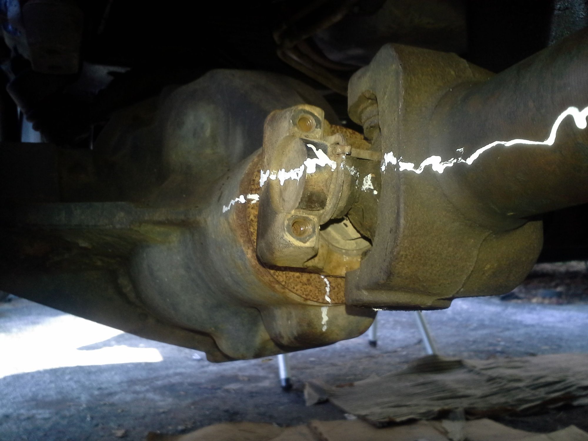

the curved straps fit right there where it has the 2 holes for the 10mm, little bolts, to hold the strap on. Theres also a second one, on the other side, that cant be seen at this angle.
The 2 little metal, curved straps, with those two 10mm bolts holding each one on are removed. You can see the groove the straps fit into, and the holes that the 10mm bolts go into. If you look just right you can see the snap ring and the long piece of wire that goes to the other snap ring on the other side. Those are what I'm concerned about. Not sure what to do and didn't want to break nothing.
I hope I got these 2 pics on here right. But yea, this is what I'm worried about. Breaking the snap rings maybe, or hitting something to get it off and I wasn't hitting the right things(s) so I damage something important, or even end up having to buy a new driveline drive shaft because of doing something stupid.
Sorry about all this confusion. I think I'm being over careful.
I really cant tell where the separation is supposed to be at! Thats got a lottt to do with why I dont have it off yet.
Again, THANKS!
