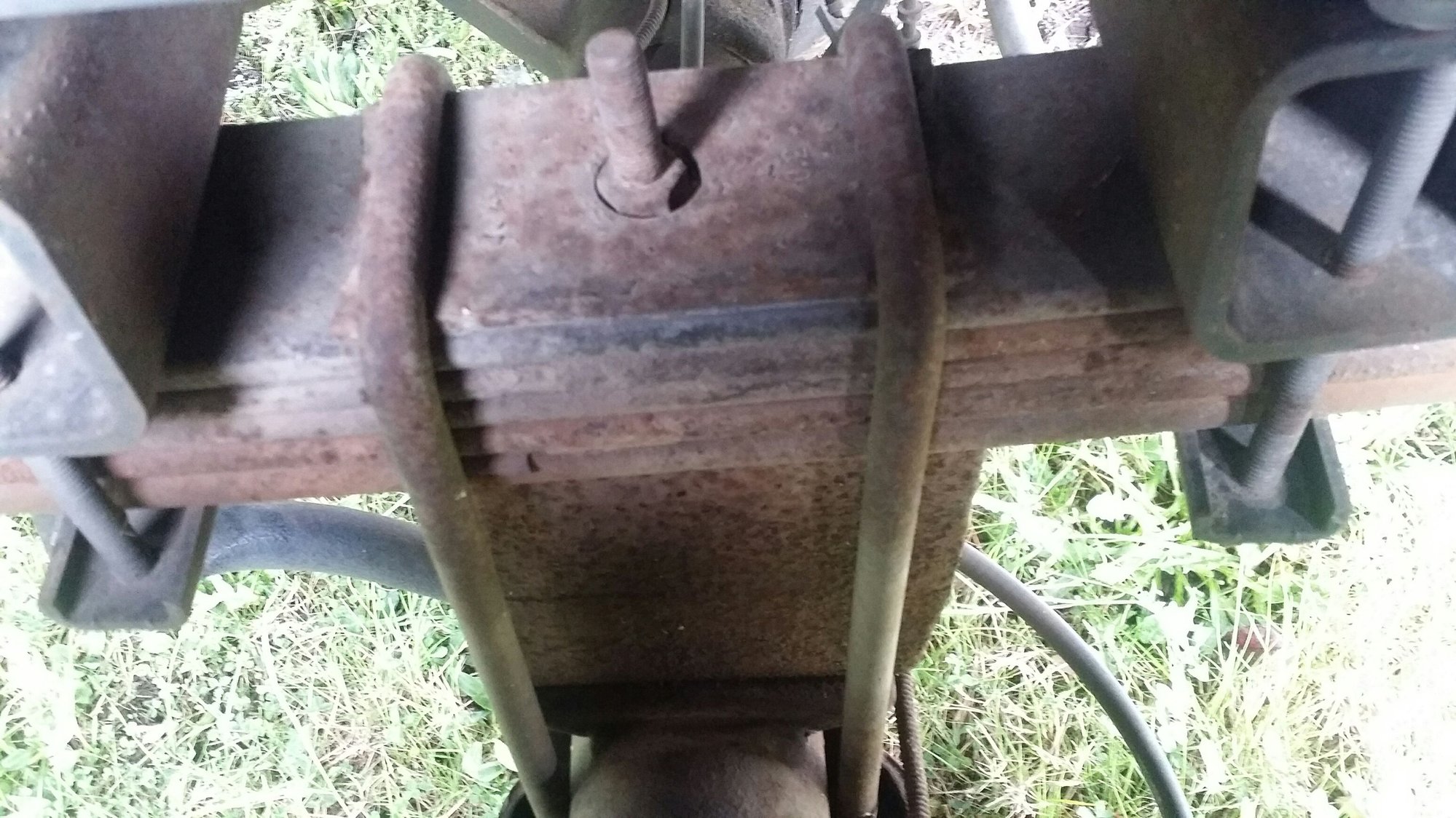

Does it look like I have an aal in the spring pack I showed in the pic?
Old Oct 16, 2016 | 07:40 PM
Posts: 87,478
AAL, or, perhaps an overload spring. Mine doesn't have those two brackets showing in the pic.

Those brackets are for my air bags.

Ah, then your springs look just like mine.
