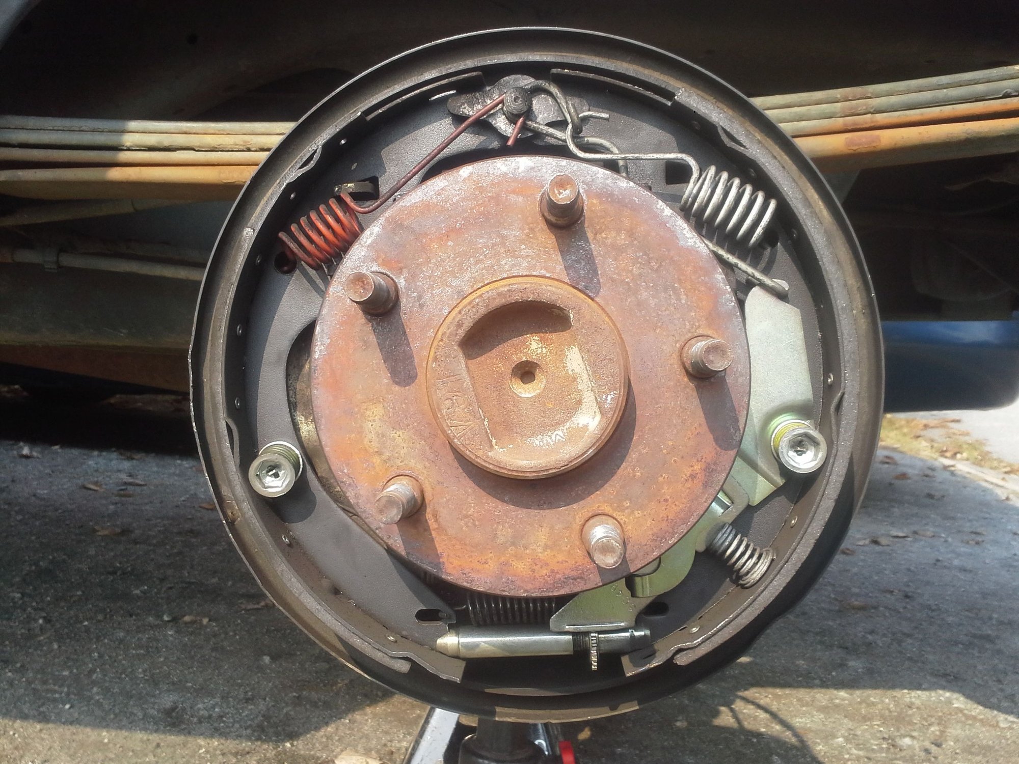

The pic is of the driver side rear wheel. When I took off the drum just now, this is what I saw. Seems like I did it right?
So, I got someone to push the brake pedal(truck wasn't started, it was off) and as they pushed the pedal, the left shoe expanded out, all the way out. But, the right shoe- it didn't even move an inch!
And then, for some reason, he continued to push the pedal. He put pressure on it until it wouldnt go down any further! All I said was pump the brakes a couple times while I watch but nooooo! Oh well, when he was getting more pressure on the pedal, the left thing shot out of the wheel cylinder and fluid followed, spurting out fast!
And the right shoe finally expanded as far as the left was. Why did the right shoe not expand? Why'd the wheel cylinder's left thingy pop out of the cylinder, allowing fluid to leak? And this means I need to buy another new cylinder for that wheel? I bought that one from AZ.
I guess I need to go the parts store and get all new parts so I re-do this one from the start. Wheel cylinder, bag of springs, clips, etc?
Take it all apart and put it all back with new, AGAIN, and see if both the shoes expand this time, in sync, at the same time?
