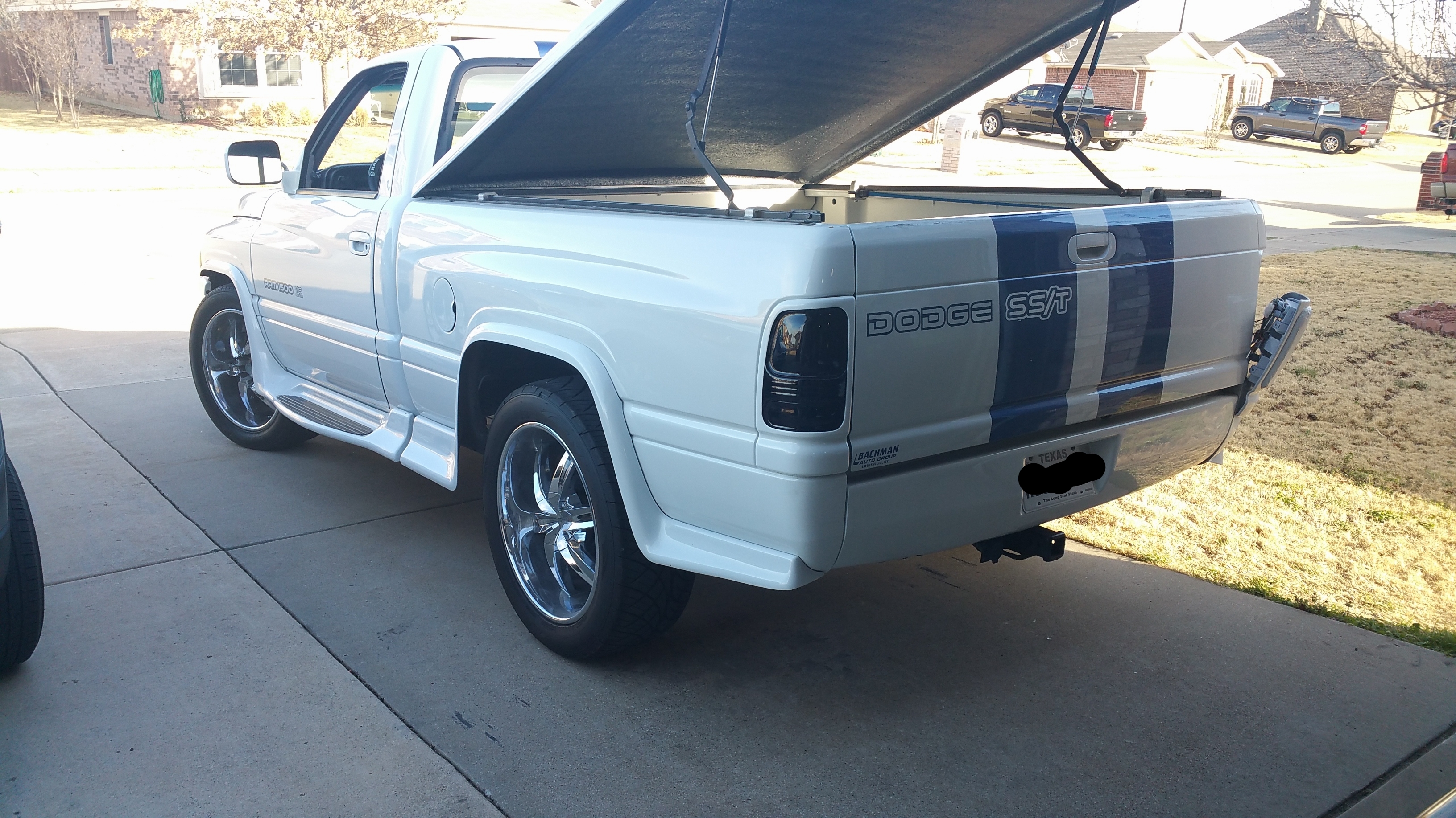

Well here is the final results of my LED Tail Light install.
I took my gas filler door into a local body shop, had them match the paint and bought a quart of it. Its a good quality paint by PPG, after mix the shop charged me $200 for the quart. It uses a 1:1 ratio for reducer so I really have 2 quarts after its mixed. I could do my whole truck with that... Its just a pearl white base.
Anyways, the LED tail lights I ordered were from LMC Truck. They were the black with clear lenses. The plastic surrounding the lense was also a bare black plastic. I scuffed them down , primed them(prob didn't need to), wet sanded the primer after 3 coats, cleaned and shot the color with my wagner electric sprayer I bought last year, did 2 coats, then I laid down 3 coats of rattle can clear. Came out so friggin nice I couldn't believe my eyes. Barely had any orange peel. I went ahead and used a light polish on them to remove some of the orange peel and my next step is to lay down a nice coat of wax and I will be done.
And yeah, you heard me right, i used a wagner flexio 590. I set it to its lowest power setting and volume was set to a medium spray. It shot the paint good enough for these tail lights I may try using it on my front bumper. It has several years of road nicks it could use a redo. primer and clear coat were just rattle can.
The new relay #552 is working great. These babies are night and day compared to the smoke lenses that were on the truck when I bought it. Now people maybe won't rear end me in the daytime because they can now SEE my brake lights
Enough of that, here are the pics:
Before with the old smoked lenses.

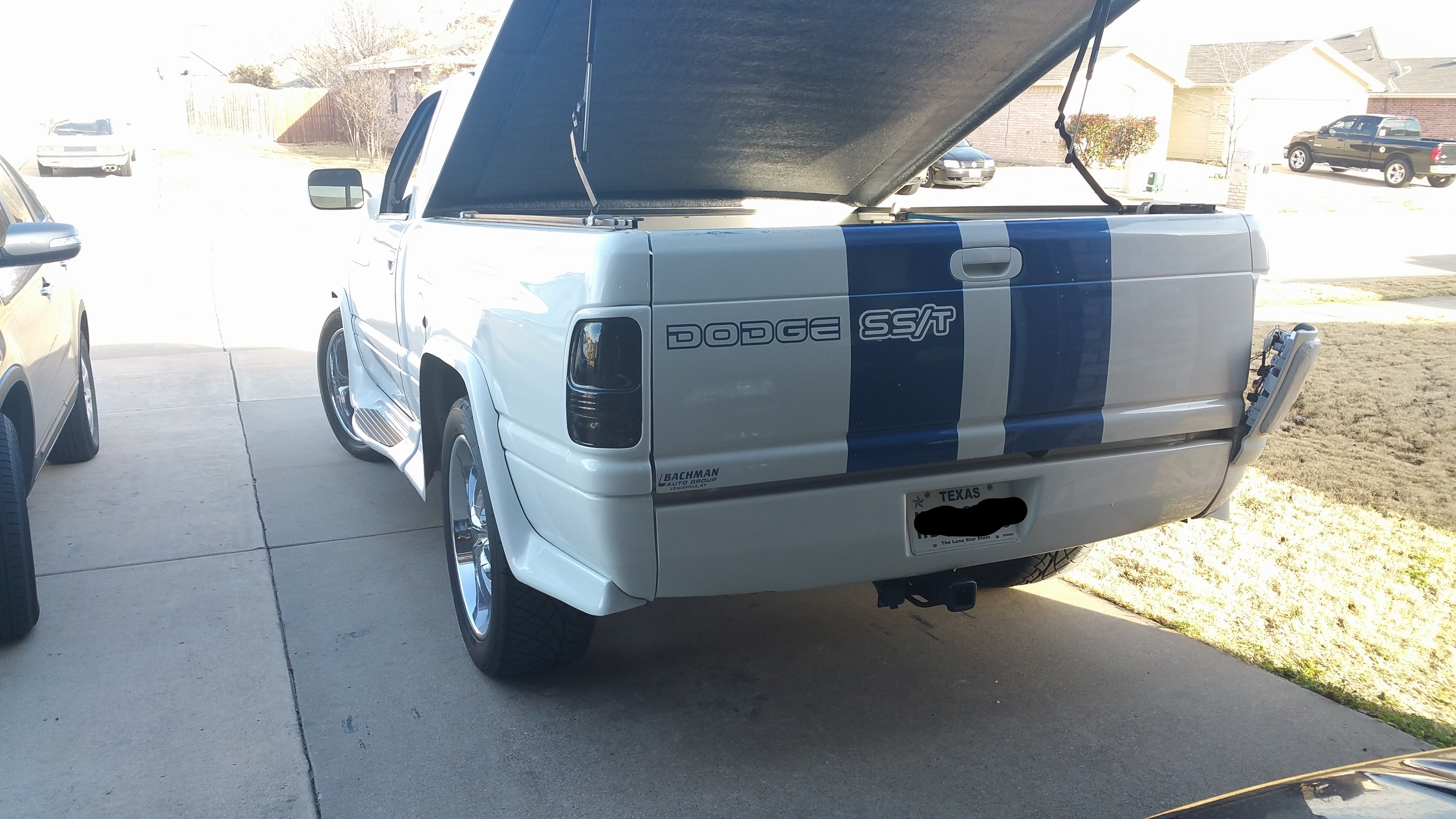

right side lamp is a new one i was mocking up.

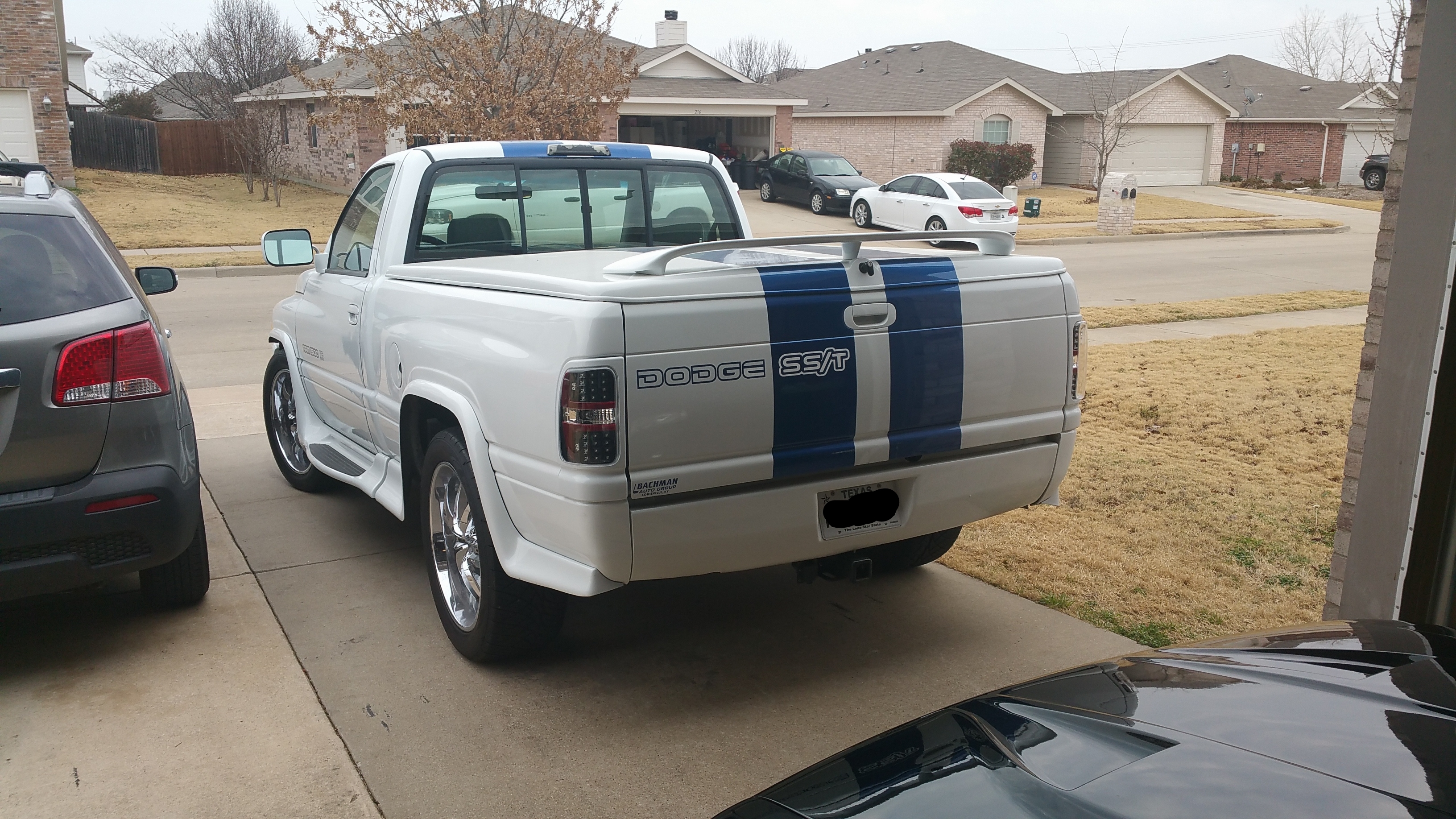

And here are the new lights, paint matched and installed
I plan on getting some night pics of them working, maybe a video. When I do I will post that too.
Thanks again for the help with the relay issue guys!
