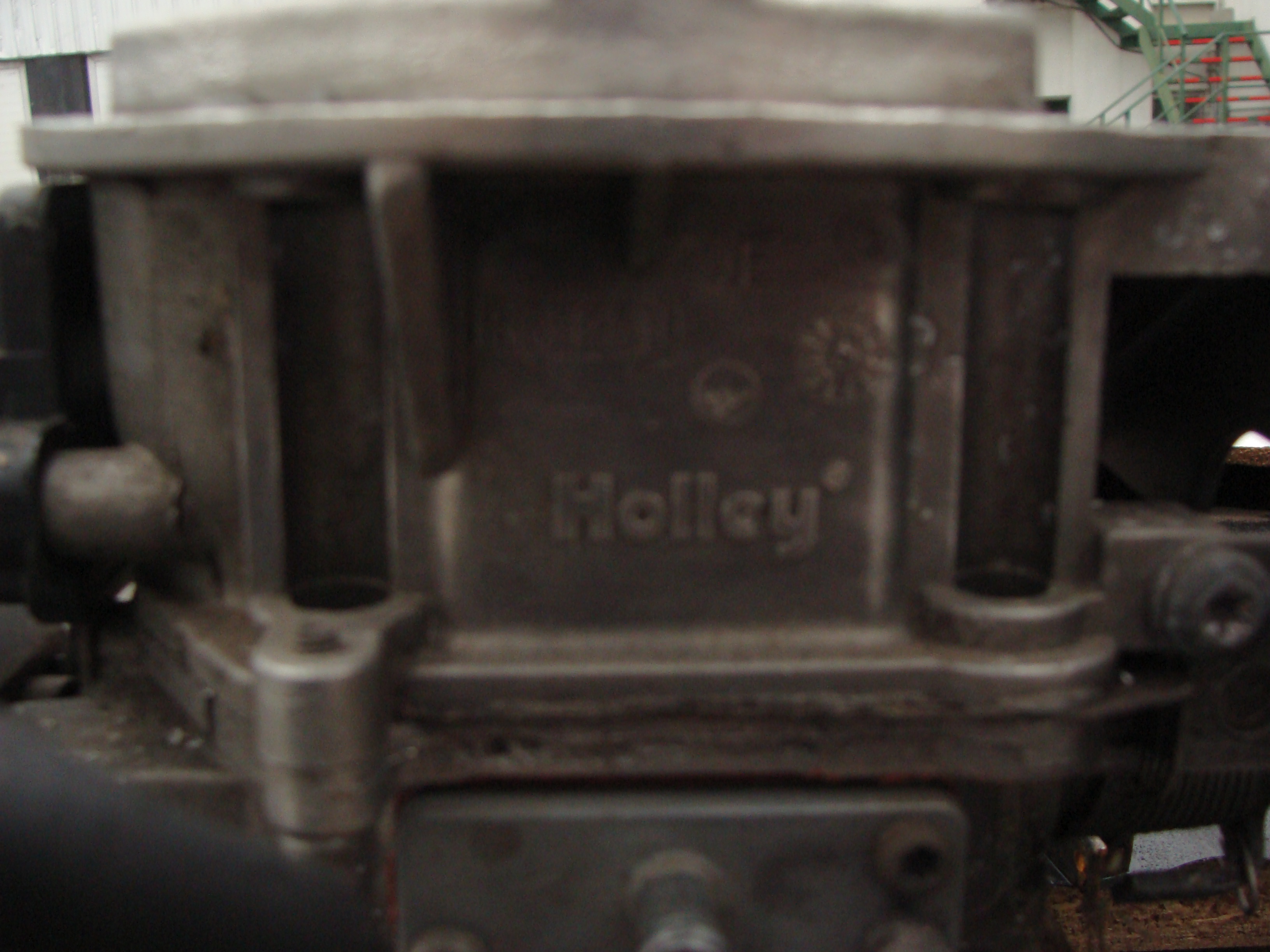

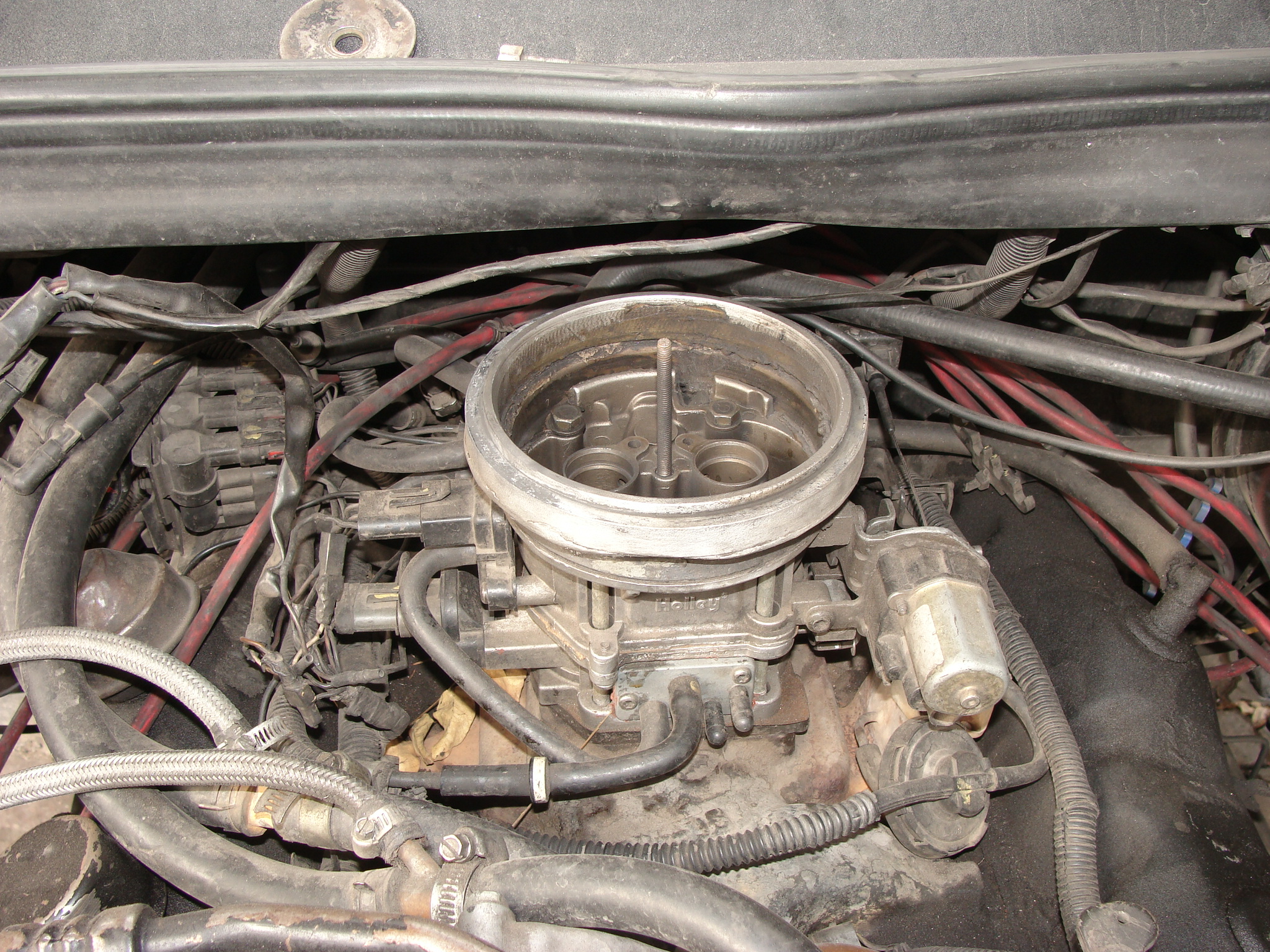

I am Hector from Argentina, if on the other side of the continent, here are few of these, many of the new, but mine is not; Because the vin says 1996 but the injection system is old, it has a nozzle holder in the Holley air system of two elements. Besides now the ecu has "disappeared", I would like to know: do I adapt another injection system, or a carburetor? Excuse the language but use the translator my english is very bad. Thank you very much.-

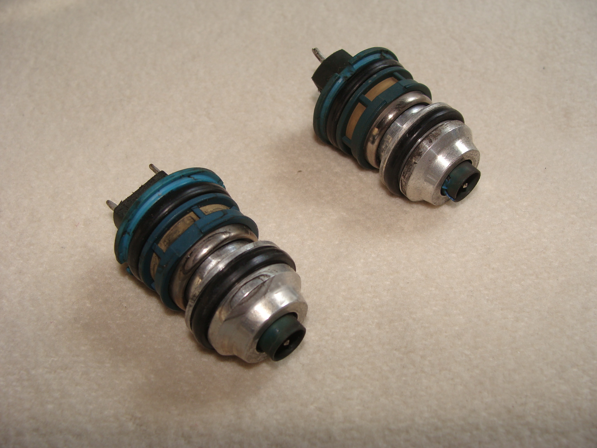

Old Jan 6, 2017 | 06:22 PM
malambotre's Avatar
malambotre
Joined: Sep 2013
Posts: 13
From: ARGENTINA
Red face
Originally Posted by 2bit
Some pictures would help.
https://dodgeforum.com/forum/attachm...1&d=1483744271
https://dodgeforum.com/forum/attachm...&d=1483744271I hope that it went up well, but Sunday with the help of children thanks
Attached Thumbnails RAM 1996 with injection system XXXXXX?-dsc05531.jpg   RAM 1996 with injection system XXXXXX?-dsc05536.jpg   RAM 1996 with injection system XXXXXX?-dsc09765.jpg
Old Jan 6, 2017 | 09:33 PM
Moparite's Avatar
Moparite
Joined: Feb 2015
Posts: 7,435
Likes: 578
That looks like the old throttle body injection that was used on the late 80's early 90's trucks.
Old Jan 7, 2017 | 09:01 AM
volaredon's Avatar
volaredon
Posts: 1,745
Likes: 50
yup and by the valve covers that tells me the engine is an old LA engine like they used before the Magnums
