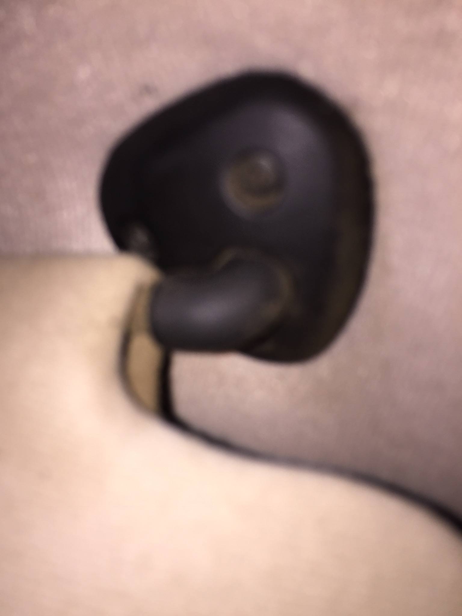

1: We need to remove the headliner, so start by removing the front pillars on left and right sides. They need to pull out towards the DOOR, NOT in towards the cab. They can break very easy. 2 clips holding the drivers in. I have the blue interior so my interior parts are hard to find, and my pasanger was not coming, so I left it in in fear of breaking it. Drivers pillar has to come off(for wiring).
2. Next remove the hanger behind the drivers seat. Gat a screw driver and pull the center clip out. Once the clip is pulled out all the way, pull on the clip and it should pull out of the roof/headliner.
