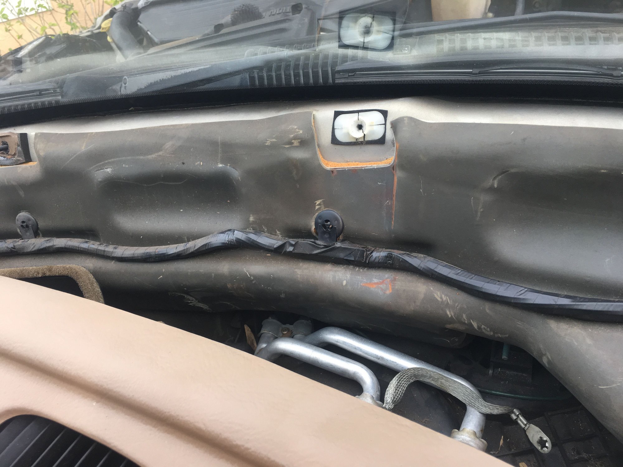

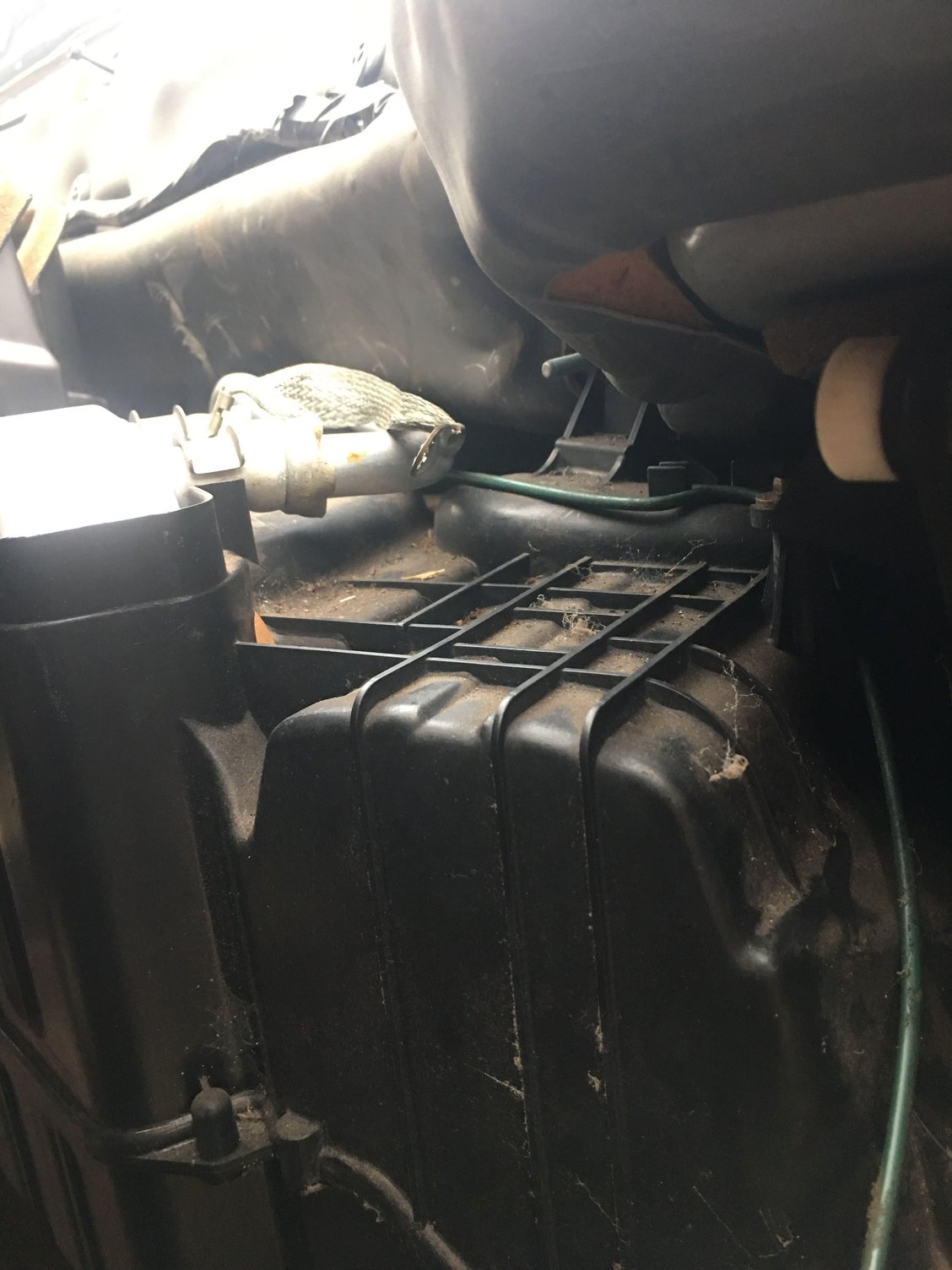

I had time to drop the dash, this is all I can see. I can't locate any vacuum hoses besides the green one. The noise is coming from where the picture is showing. I'm almost positive it's the line going into the firewall

I cut and re-routed my vacuum line going through the firewall and it still does it. I didn't bother with the green one because I figured the actuator is working so it must have vacuum going to it? I'm really stumped on this, as the noise is coming from glovebox area. I checked vacuum lines under cowl and they checked out ok. Which way are the check valves suppose to be facing? I'm stumped, it sounds like a vacuum leak to me, it only does it when you hit the gas and only when your in gear doing it. It's very loud, and I feel a power loss from a dead stop. Maybe I just have wild vents? And the noise is the wild vents kicking in, but when I hear this sucking noise as the Rpms raise then I hear the wild vents kicking on.
