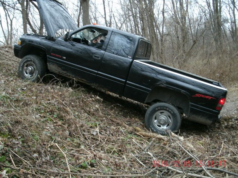

Almost universally all of the 2nd gen trucks we've dealt with here on the forums for cooling system issue, end up with poor heat. The most common suggestion is raising the front as high as possible, ramps, jack, steep hill, whathaveyou. I think I have a pic around here somewhere of mine, parked on as steep a hill as I could get it up. It kinda/sorta worked, but, not as well as back-flushing/filling the heater core. That's why I think the flush T will do the job quite well. I plan to install it at the highest point in the cooling system, right near the outlet of the heater core. It's a drag to get to... but, my heater should be able to burn me out of the truck, and it barely keeps it comfortable in the sub-freezing temps we have had lately.
I think I am going to grab a stant thermostat, and give it a shot. Probably not tomorrow.... I have a date with my granddaughter, that I don't wanna miss. (daddy/daughter dance, her daddy just ain't in the picture, thank god.....) Also, I don't think advance has one on the shelf either... according to the website, all they had was the carquest feller..... I'll pass, thankyouverymuch.
Edit: Here's the pic.
