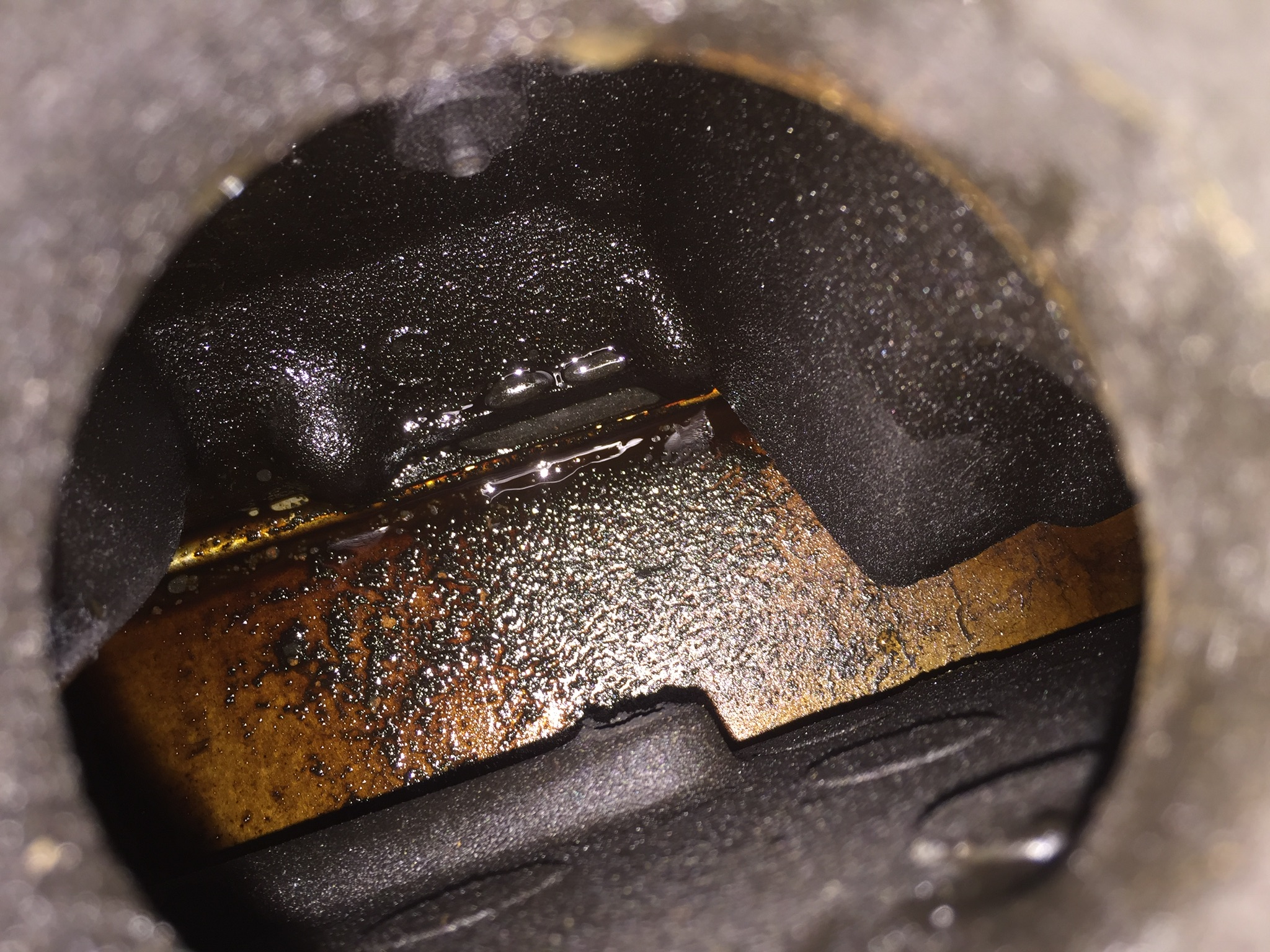

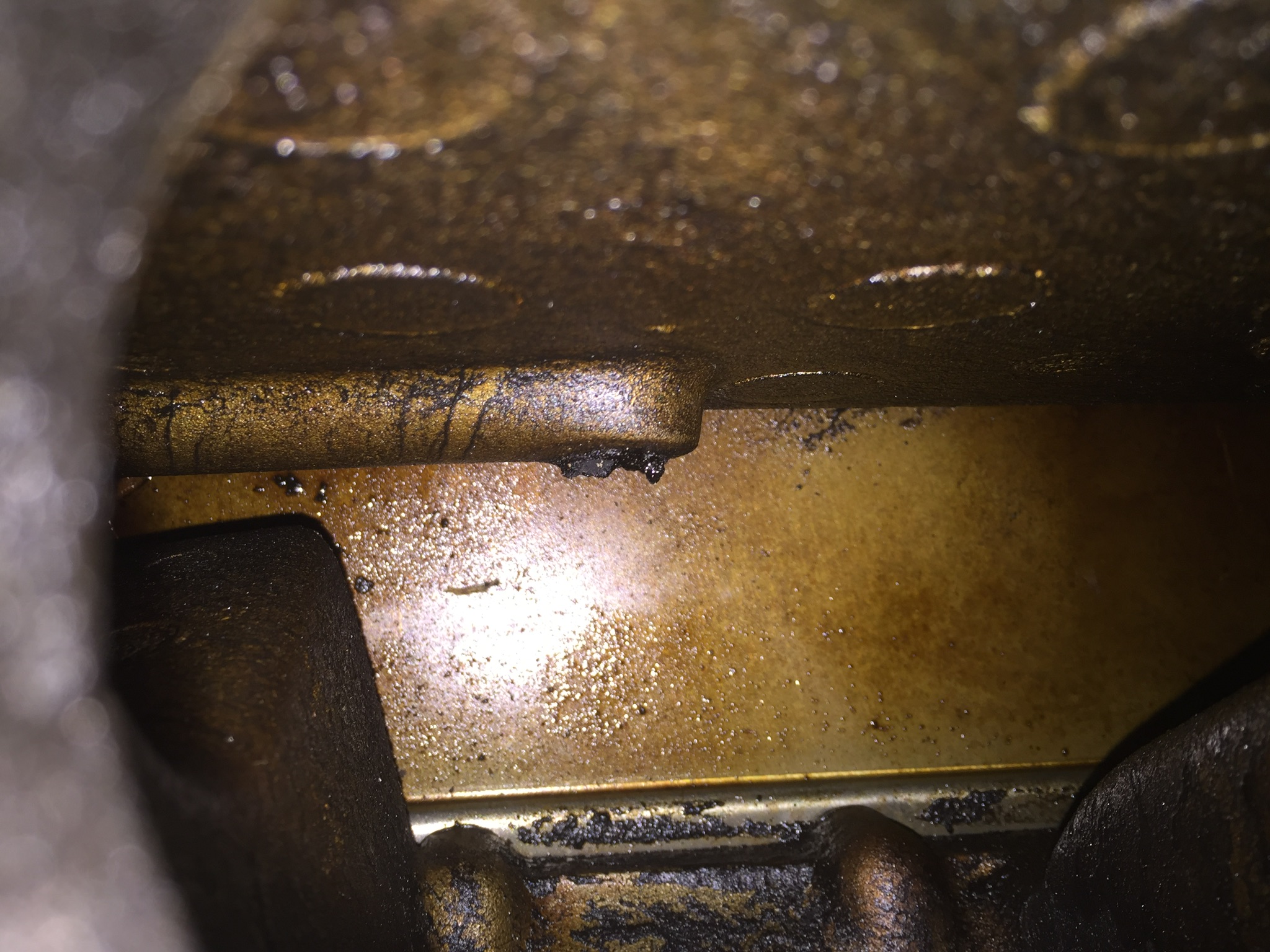

So I spent a good 2 hours at the junkyard today pulling some parts, one of which is a Keg intake off a 94. I made sure to get the one with the egr port.
I'll be cutting down the runners, as well as taking the center divider out, and grinding out where the fuel injectors go for better atamization.
But this intake is NASTY. How would y'all go about cleaning the carbon and soot buildup from inside the intake.

I know I'm going to take it to the machineist to check for trueness and flatness of all mounting surfaces, and one of the bolts for the thermostat housing snapped off in the Intake aswell. Should i just have them clean it? I know some small shops around here don't like when you bring them the dirty as crap stuff.

Sand- or media- (nut shells, aluminum oxide) blast.
Think harbor freight...

First, remove the plenum plate off of it. Then, from the bottom side, spray the inside of the intake down with some Purple Stuff cleaner (either Castrol brand or generic) and let it sit awhile, then hose it off. If you have a self-serve car wash nearby that has self-serve power sprayers, that works real well when hosing it off. Spray it again with the purple cleaner and repeat the rinse. Once you get it as clean as you can with this process to degrease it and let it dry, I would have the machine shop (or a friend with a decent bead blasting cabinet) bead blast it thoroughly clean with glass beads. I did my kegger this way and it came out very nice.

Yep, pull the bottom plate, and then have them toss it in their hot tank. Media blasting will make the outside look nice.
