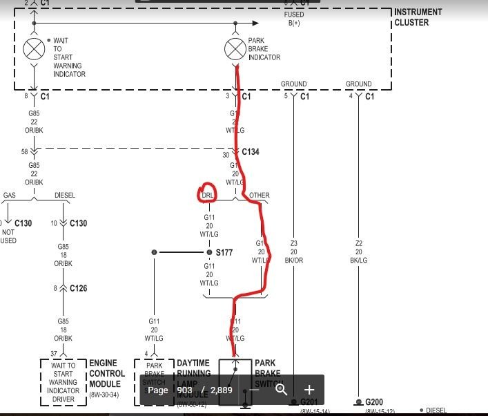

Going off of this diagram
http://redirect.viglink.com/?format=...&txt=2000-2001
It looks like I've got a short between the light and the switch. On the optional wiring, what does "DRL" stand for/how do I know if the truck is "DRL" or "Other"? I thought it might be a transmission code but that abbreviation isn't listed
