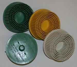

I wouldn't advise using the roloc/scotch brite pads on areas with exposure to the crankcase. The particles produced are too small to be caut be the oil filter and will toast your bearings. GM and many other companies have put out TSBs and other info regarding NOT to use these types of pads.
What I use is the Roloc Bristle Discs. The white one is good for aluminum. Just don't push too hard or the bristles will fly off.
