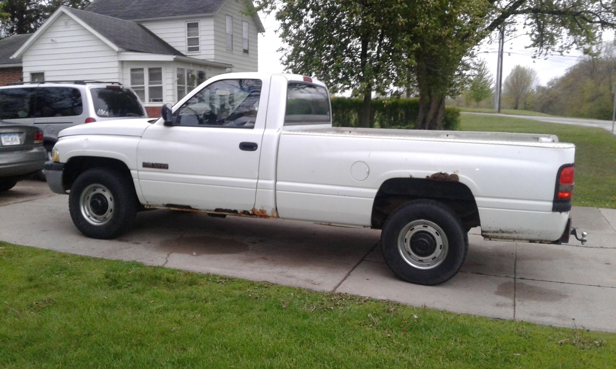

Of the kit or truck
Old May 28, 2017 | 07:30 PM
Jacob Peterson's Avatar
Jacob Peterson
Joined: Feb 2017
Posts: 51
From: Iowa
After
Before
2.5 rear blocks and 3"front coil spacers
