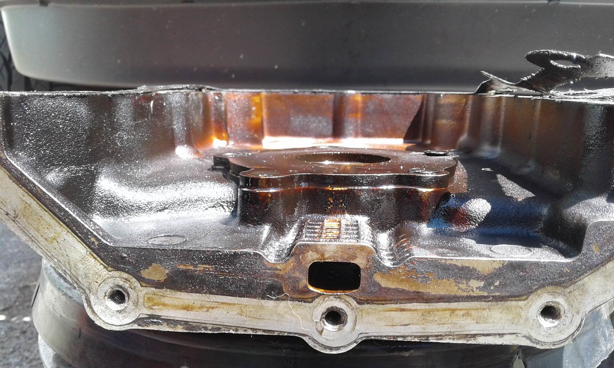

I got screws loose. In my head because I drive a v10 and in my timing cover. I took off my timing cover and I had two visibly loose screws and one that was finger tight. The rotors are within tolerances according to a micrometer and feeler gauge. But the outer rotor clearance limit is a little over maximum. Maximum is .006" and my feeler gauge is saying .008"-.009". The timing cover itself is warn a bit. I'm gonna use it anyway as their is no guarantee that a used one will be any better and I can't find a new one.
I had 2 screws visibly loose and one that was only finger tight.
Screws Loose.
Rotors look good, I put a micrometer on them and they are within tolerances. I also used a feeler gauge for clearance over rotors and rotor tip clearance, both within tolerances.

Not so long ago, I was actually able to find some for sale, today though, not a single one. Part number is 53020971AB. Not even finding anything on ebay used.....
