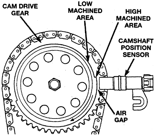

This is from the 2001 Service Manual that I downloaded. There is an illustration that I can't seem to copy over to here. Found it online.
INSTALLATION - 8.0L
Replacing With a New Sensor
(1) Apply a small amount of engine oil to the sensor
o-ring (Fig. 14).
A low and high area are machined into the camshaft
drive gear (Fig. 15). The sensor is positioned in
the timing gear cover so that a small air gap (Fig.
15) exists between the face of sensor and the high
machined area of cam gear.
Before the sensor is installed, the cam gear may
have to be rotated. This is to allow the high
machined area on the gear to be directly in front of
the sensor mounting hole opening on the timing gear
cover.
Do not install sensor with gear positioned at
low area (Fig. 16) or (Fig. 15). When the engine
is started, the sensor will be broken.
(2) Using a 1/2 in. wide metal ruler, measure the
distance from the cam gear to the face of the sensor
mounting hole opening on the timing gear cover (Fig.
16).
(3) If the dimension is approximately 1.818 inches,
it is OK to install sensor. Proceed to step Step 9.
(4) If the dimension is approximately 2.018 inches,
the cam gear will have to be rotated.
(5) Attach a socket to the vibration damper mounting
bolt and rotate engine until the 1.818 inch
dimension is attained.
(6) Install the sensor into the timing case/cover
with a slight rocking action. Do not twist the sensor
into position as damage to the o-ring may result.
Push the sensor all the way into the cover until the
rib material on the sensor (Fig. 13) contacts the camshaft
gear.
(7) Install the mounting bolt and tighten to 6 N·m
(50 in. lbs.) torque.
(8) Connect sensor wiring harness to engine harness.
When the engine is started, the rib material will be
sheared off the face of sensor. This will automatically
set sensor air gap.

ok, I found it in my 96' manual. Yup, I did it wrong, just slammed that baby in there. It broke.........just like the manual said it would. I just ordered one off ebay as (no surprise) the part is discontinued and I can't get one locally. I was hoping to be starting her up today, gonna have to wait till Friday

Got the camshaft position sensor today. Put it in fired her up and what do ya know? I have beautiful oil pressure again. 40 psi at idle and a bit above while cruising. All because of a couple of loose screws on the rotor retaining plate. The small oil leak coming out of what was almost a brand new crankshaft seal seems to have stopped since I replaced it again with the one that came with the timing cover gasket. They were different part numbers though they looked almost the same. Now I have a new oil leak...lol...think it's from my oil pan...I reused the gasket, possibly some grit settled on there when I put it back together. Such is life, gonna have to drop the oil pan again..possibly.
