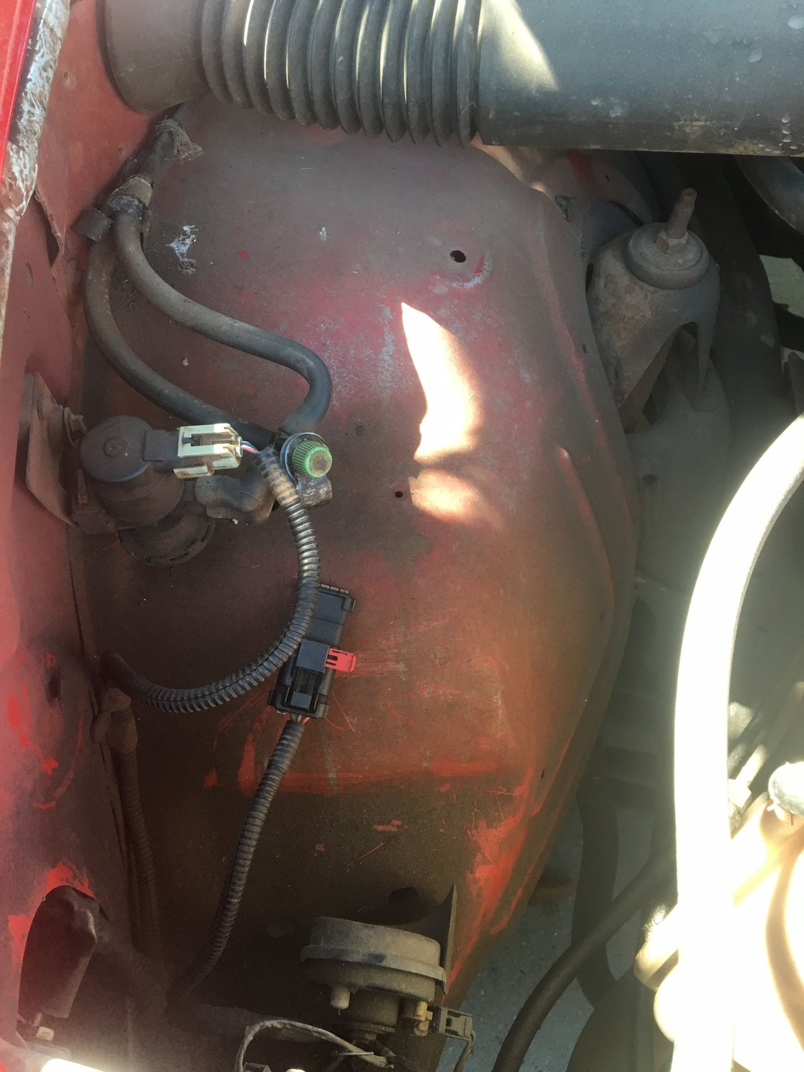

I see the electrical connector for the ldp and it has a blank plug. What software would tell me the pcm info
Old Sep 4, 2017 | 02:28 PM
BklynRam2500's Avatar
BklynRam2500
Joined: Aug 2017
Posts: 7
Here is a picture
Old Sep 4, 2017 | 03:17 PM
Posts: 87,397
Likes: 4,213
Looks like there is something plugged in, to keep it clear..... and it looks factory..... That's strange. What's the part number on the PCM?
