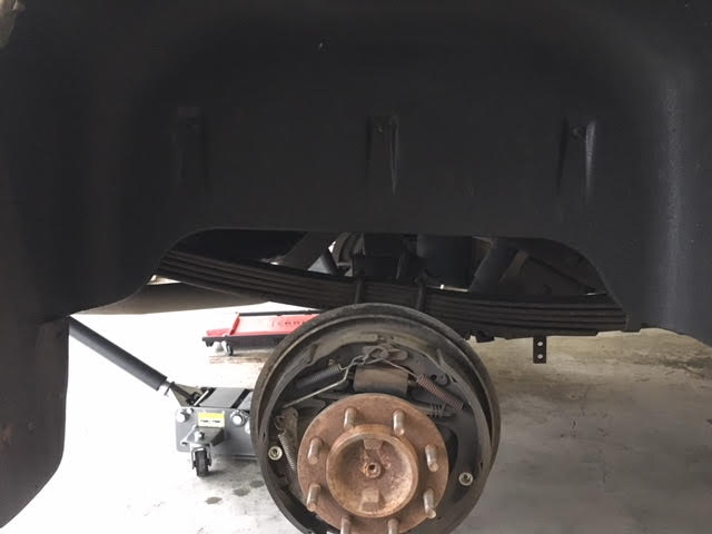

So I got home and got it up on stands and took the rear wheels off to have a good look at the leaf springs. Got my wife to help me take pictures. The following are pictures of them. I had her center the tape measure on the bolts that hold the springs. They are clearly longer on the rear half of the spring by 4 inches. The longer portion of the spring is towards the rear of the truck. I don't know which way they are supposed to go. One of the pictures shows the side view of the springs and it just looks strange. I think if I take them and flip them around, i think it'll be correct then. You can see the whole block and spring is tilting forward (yes I know it's on stands and leaning forward to begin with). Am I just wet? Does anybody think this is odd looking? Anybody know for sure which side of the spring is supposed to front or back? The axle itself is centered where it should be, but I think flipping the springs will rotate things back to where they should be.

If the axle is fairly well centered in the wheel wells, the springs are installed properly. Moving the axle four inches will be a MAJOR difference, and will likely offset it enough, that you won't even be able to put the tires back on, without hitting something.

Well this weekend I had the drums turned. The shop that did it for me said they were way out of wack. He said he barely got them true again. Still having it on jack stands, I put the drums back on, fired it up and sped it up to 60 mph. The shake feels about 99% gone! At least it's gone when the rear tires are turning, we'll see about the front end but I feel confident that those were my issue now. Didn't get to take it out on the road yet because I wanted to start on getting the redhead installed.
