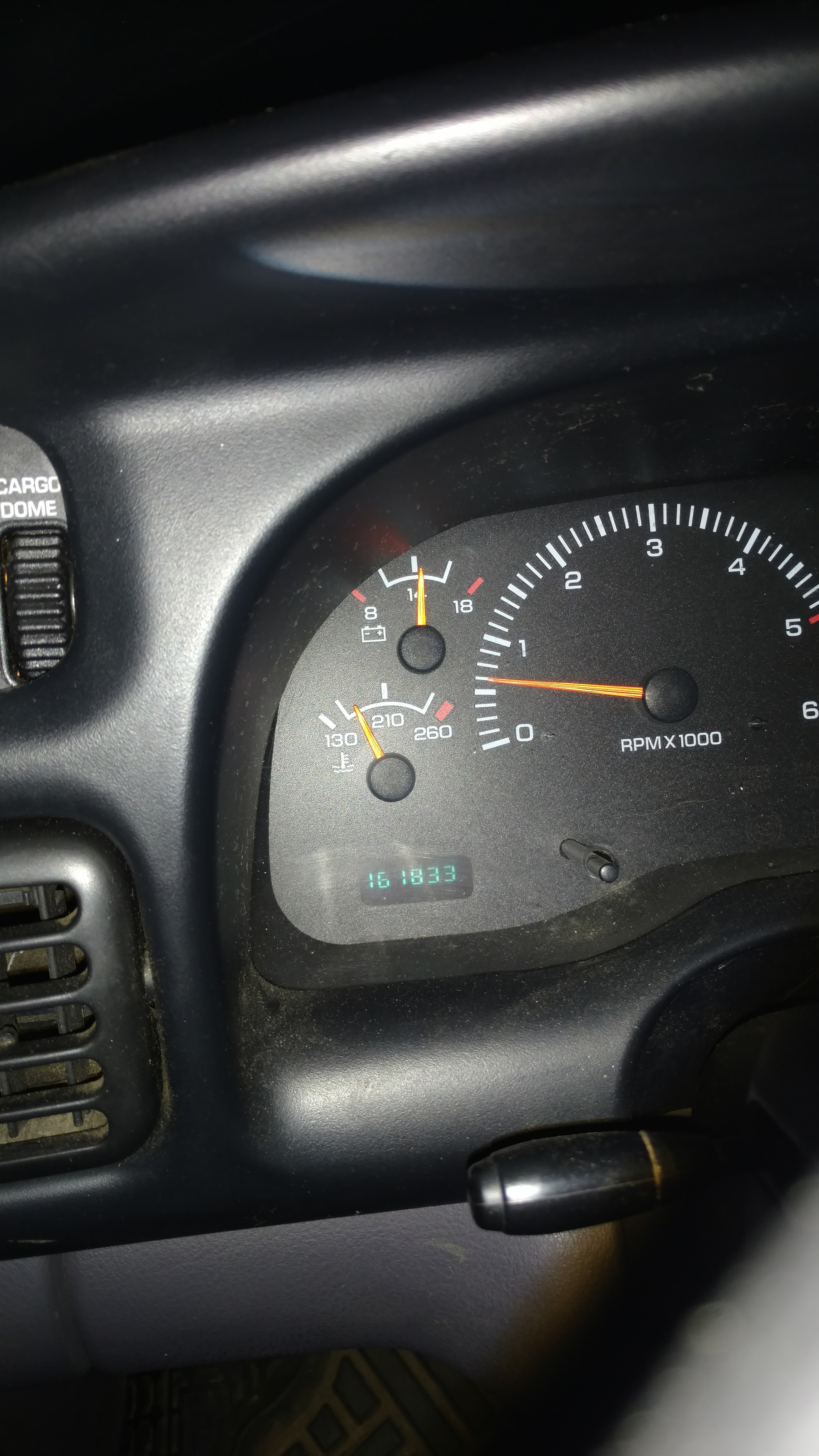

I finally got to the point of firing my truck up and trying to burp the cooling system after replacing the timing cover gasket, water pump, thermostat, and hoses. While apart I switched out to a 180 degree thermostat for the first time. My concern is that even after 45 minutes, the truck just never really seemed to warm up. The heat started getting luke warm, but normally it would burn you out of the truck. So I'm wondering if I have a thermostat that is stuck open, of if this is just the nature of a 180 degree thermostat. I've attached a picture of the highest point that my temperature gauge got to. This was after sitting idling for 45 minutes. Does this look normal, or do I have a thermostat that's stuck open?

Thats the normal position, i have a dakota, but, its the same gauge you have, and thats about were mine runs with a 180 thermostat...

Perfect here too. I've run four 180 stats over the years since the haydays of ping.
If you're above the Mason-Dixon line, you need to put something in front of your radiator or you'll never be warm. I use old floor mats cut up to fit the grille slots. Poor man's winter front. Helps warm up quick and has nice heat. Except my core is going out but that's a different issue . . .
