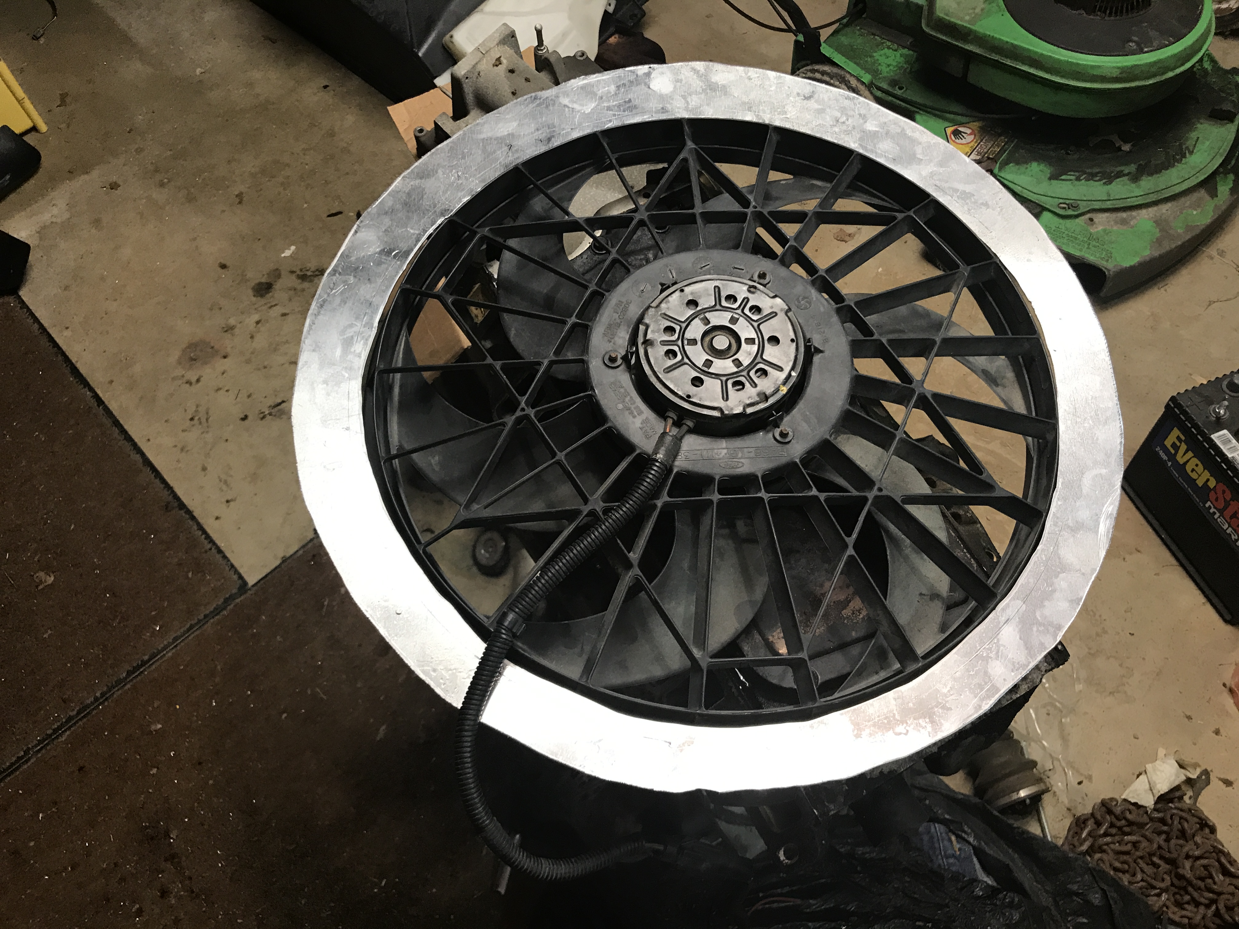

Finally got the engine fired up tonight. I got the long tubes on what a pain. And boy was it loud off the headers. just need to get it filled with coolant and burped. I'm also in the process of making mounts for my efan. But need to find a good fan controller with a threaded probe. I took the plate off my old intake to see how bad the leak was and it was missing about 3 inches of the gasket. So I'm hoping this fixes my oil loss.

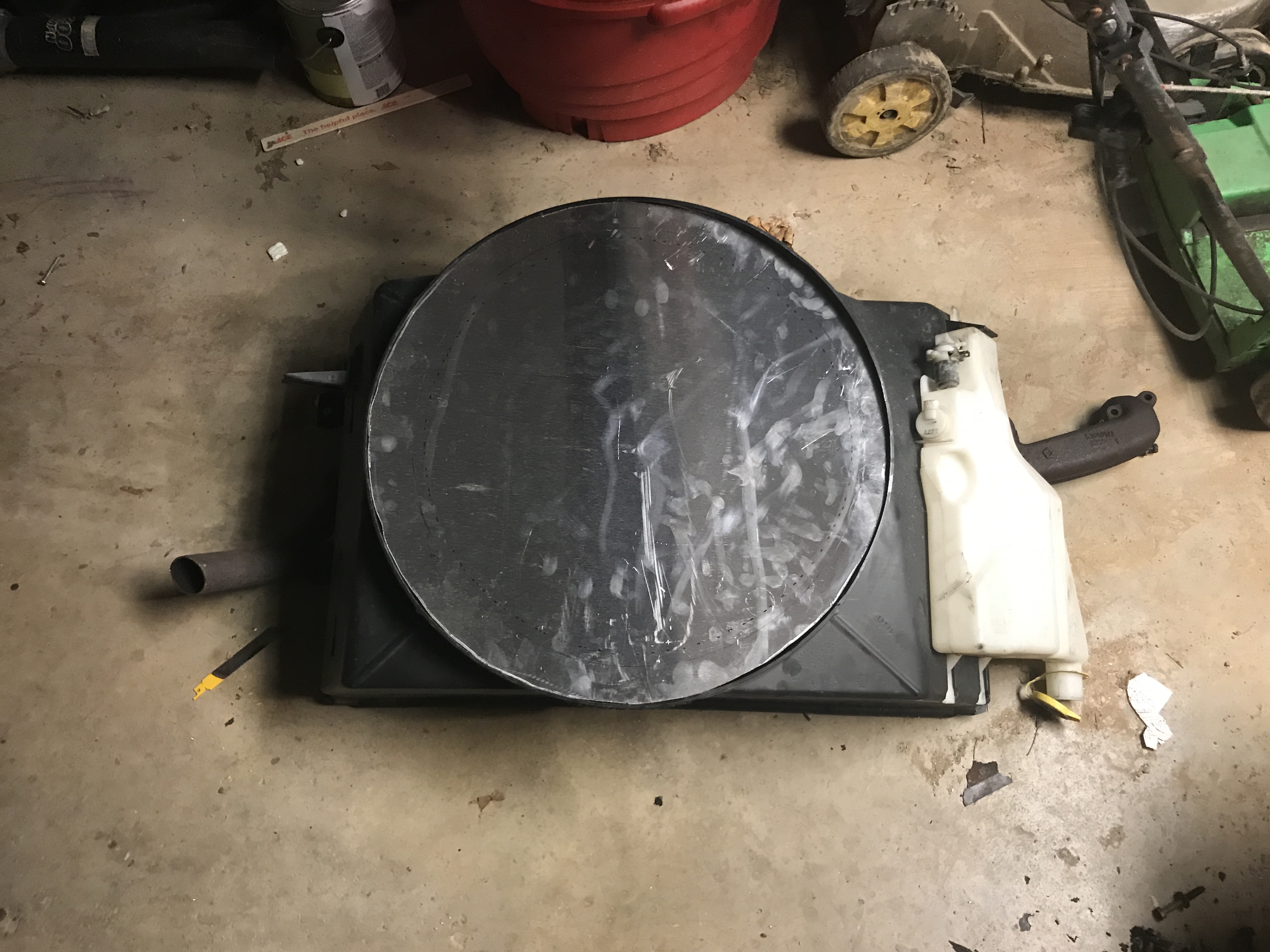

I worked on the efan mound today. I used a solid sheet of aluminum and cut it out with a nibbler. Turned out pretty well.
