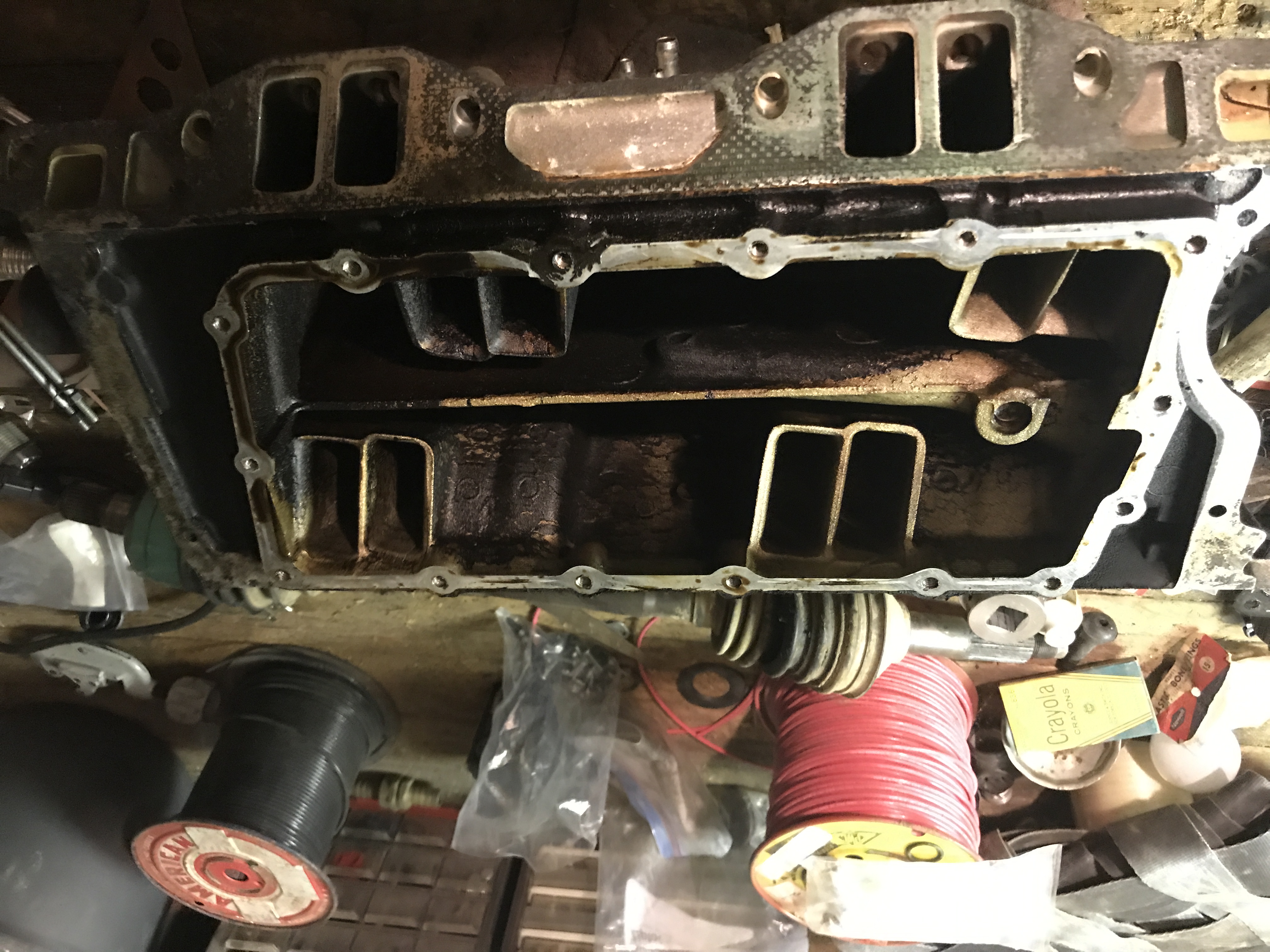

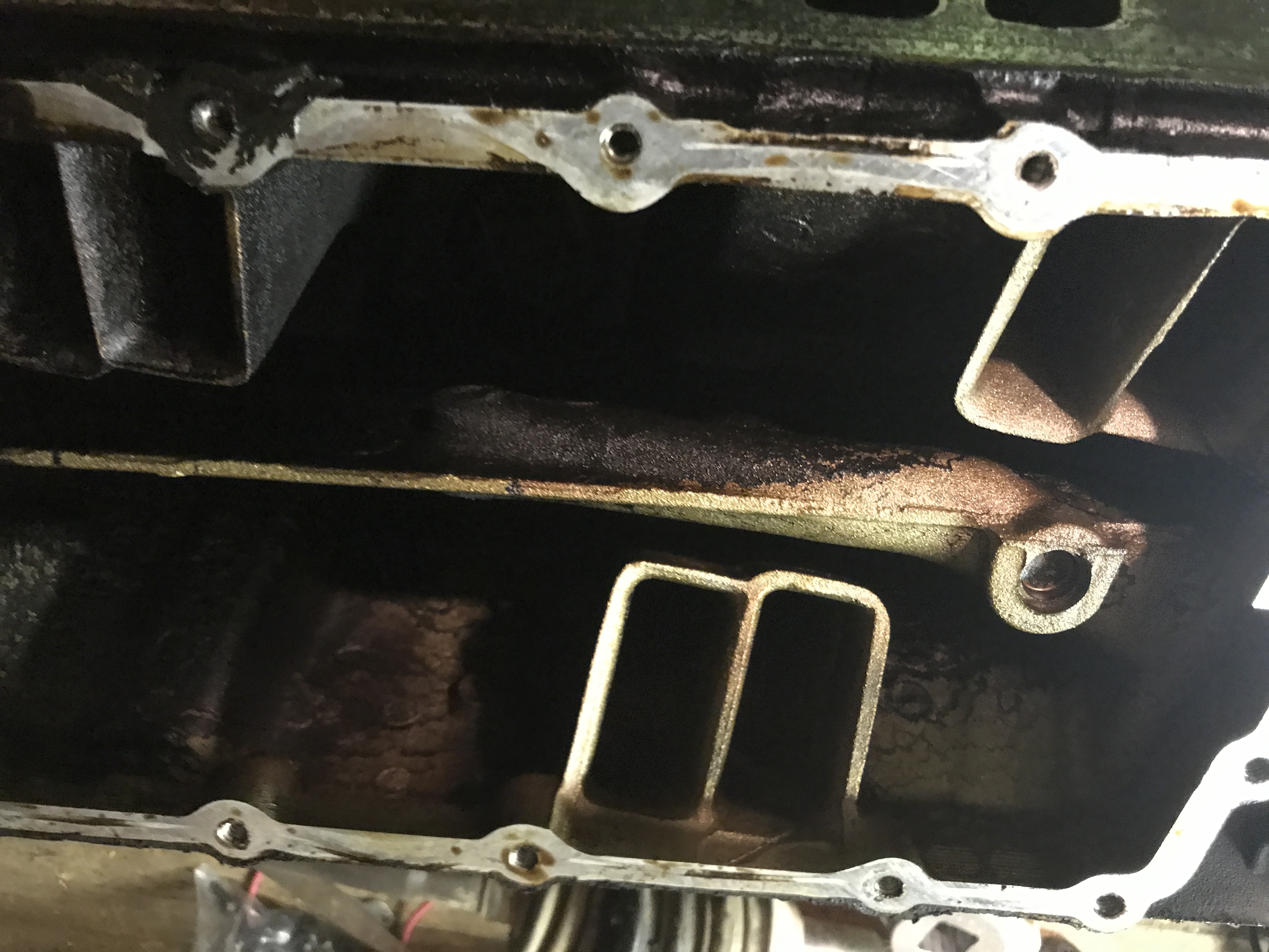

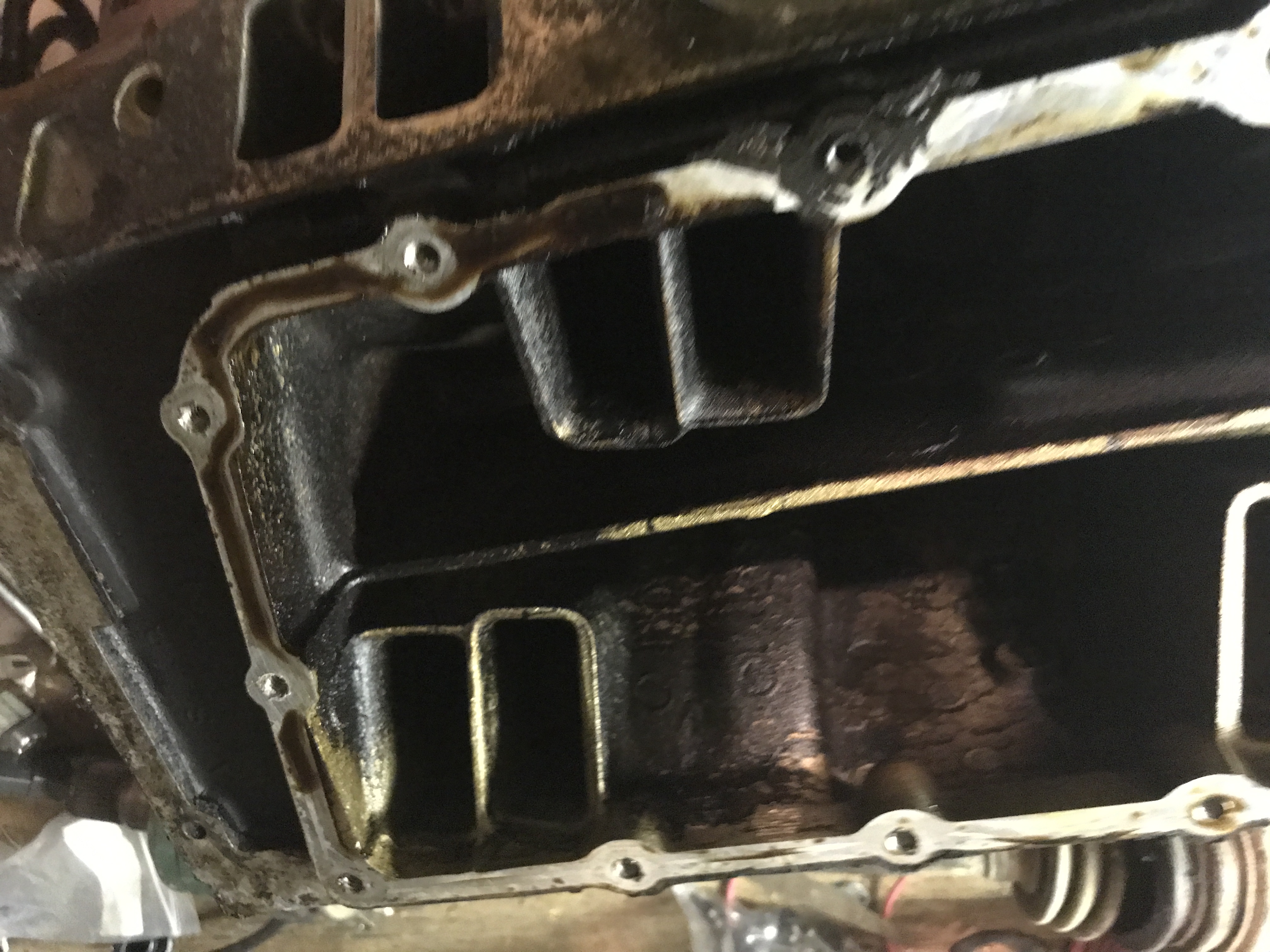

These are just a few pictures of the blowen gasket.
Attached Thumbnails Finally after a few years I got to the plenum repleament.-img_1644.jpg   Finally after a few years I got to the plenum repleament.-img_1645.jpg   Finally after a few years I got to the plenum repleament.-img_1647.jpg   Finally after a few years I got to the plenum repleament.-img_1646.jpg

BigRed...does your intake have an EGR??? I've never seen that well sticking outta the center divider before.
Yeah, the OBDI trucks had EGR, the center divider went away in 98, or 99.

I had to replace my 95 ram plenum gasket twice. I found the plenum bolts were loose. so I replaced with new bolts and used blue Loctite on the bolts. no problems so far so far with plenum.

I deleted the egr on the intake I swapped in. The aluminum is .055. My dad worked for an aluminum plant. It was a scrap sut off a coil. You could use something thicker but there's really no need and it would make it harder to cut. As for the plenum I used the Hughes kit and also used blue loctite on the new bolts.
