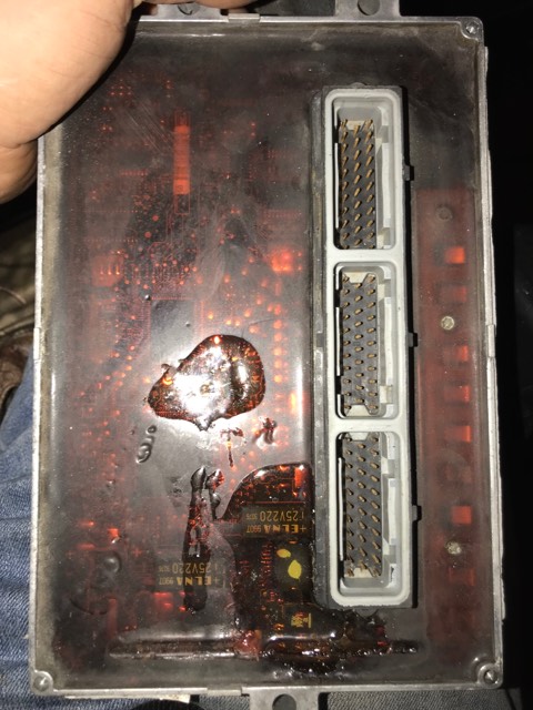

this is what the pcm looks like and also the noise my fuse box was making

Is that burnt there in the lower part of the pic? If it is..... time for a new one.
Im assuming it is burnt out. Is there anyway i can swap one out of a junk yard. aint really got a extra $300 for a new computer

You could grab one from the yard, providing you can find one...... (has to be 99 though, I think to much changed on either side of that.) And you will have to have it flashed to your vin if you want ABS and Airbags to work right. (at all.....)
What if the numbers on the computer match up? Should be same computer right? i don't much about the computers and stuff

98 was kind of an odd year, with some serious mid-year changes..... 2000 changed sensor values for the trans..... so, to be safe, you need the 99 PCM, with the same engine/trans that you have in your truck. (could conceivably have it flashed if only the engine is different.....) but, you will have to get it flashed to the correct VIN, in order for ABS, and SRS to work.
So if i get one out of junkyard same year model same motor trans. then truck will run fine without abs? and airbags?
