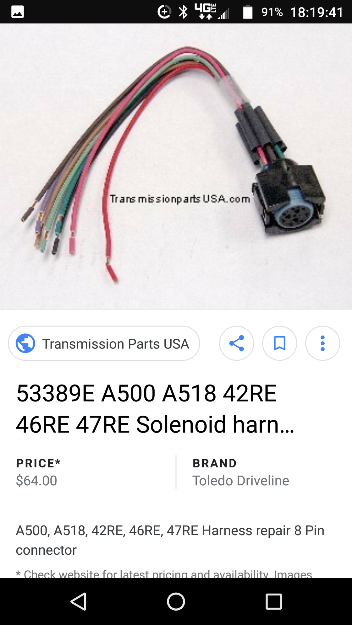

Try this test. Unplug the 8 pin connector on the trans, drivers side, about halfway back. This will disable the electronics in the trans, so, NO automatic function at all. None. Zero. TCC and O/D will also be non-functional. So, start in first gear, shift when you need to, (both up and down.) and see if things feel any different.

Thanks HeyYou, I checked the trans, I only see a single 3 pin connector on the driver side of the trans. Then another 2 pin at the rear of the trans. Maybe the 3 pin?

Found it, thank you. Hidden behind the shift cable.
So driving with the 8 pin connector disconnected, shifting the trans manually between 1 and 2 did nothing. shift between 2 and D works. Trans feels like its stuck in second even when shifting into 1. But with the 8 pin connector reconnected, I can shift between 1 and 2 just fine. Still the same sluggishness when in 1st. Also feels exactly the same sluggishness when in reverse, connector connected or not. Is this the expected result?
