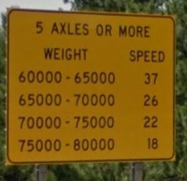

you can go as fast as you want/can up a mountain, but if you're heavy you need to go slow down it. like 15-20mph or even less if you're really heavy/overloaded. you can go too slow anytime, but you can only go too fast once.
i think this sign would be valid for speeds you should go based on how you're loaded. 80k would be equal to fully loaded for your trucks rating.
this is the sign from deadmans pass in oregon, I84 west, near pendleton. there are similar signs for major mountain passes around here.
