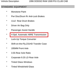

1996 Dodge Ram 1500 Sport, 4X4, 5.9 (360) Gas engine, 46RE Trans. 164.000 miles

Attached Thumbnails Shift problems 46RE Trans.-screenshot_20180207_083715.png

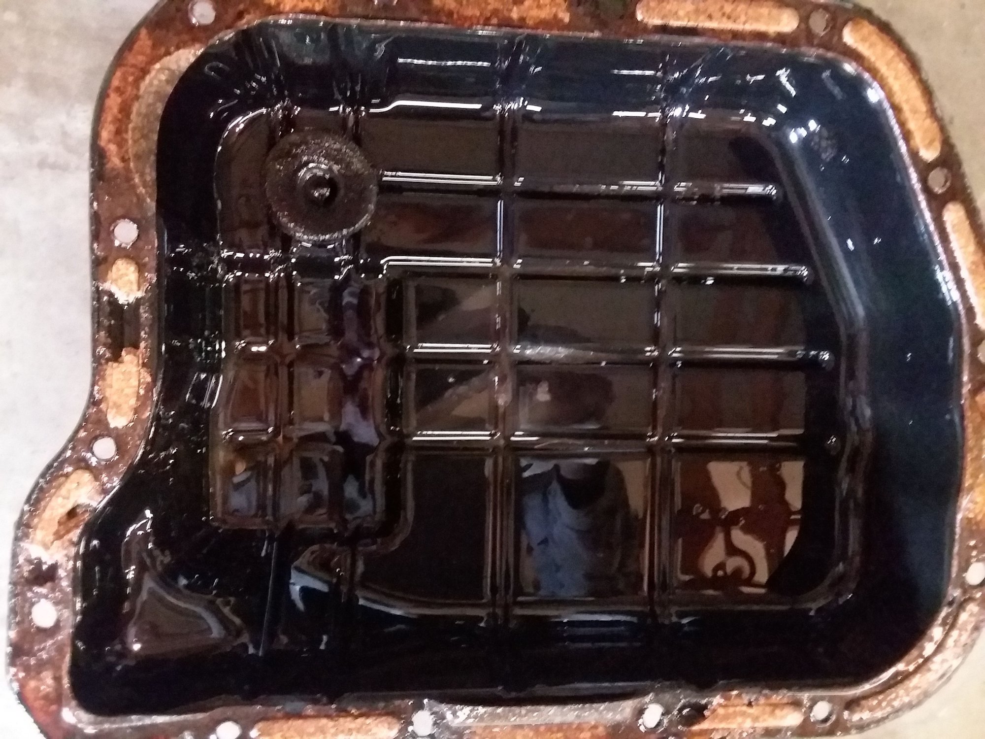

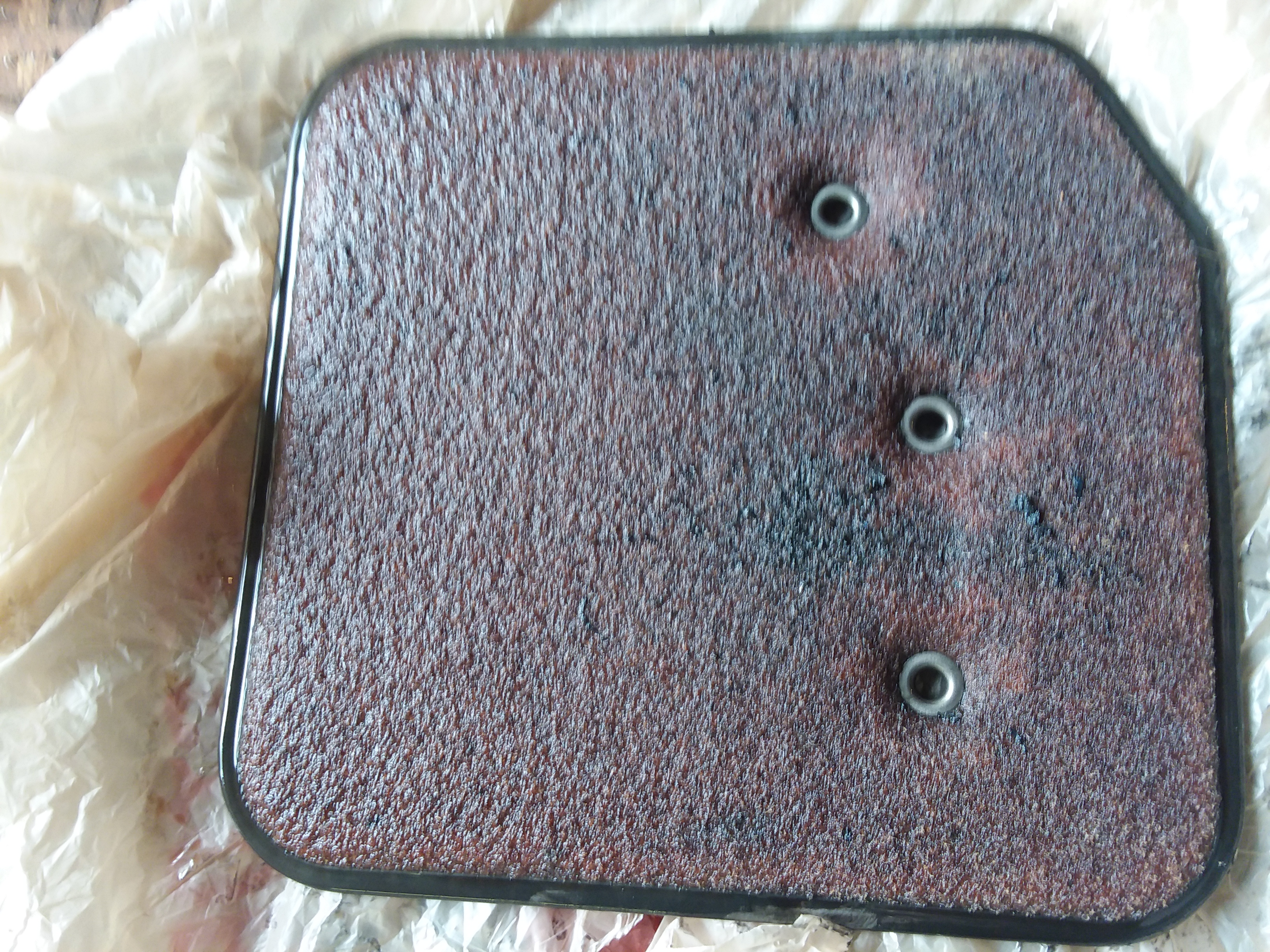

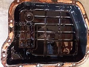

Here is my pan and Filter straight off the transmission 164000 miles
Attached Thumbnails Shift problems 46RE Trans.-20180213_112823.jpg   Shift problems 46RE Trans.-20180213_113201.jpg
Old Feb 13, 2018 | 12:54 PM
Posts: 87,409
Likes: 4,214
Really doesn't look that bad.
