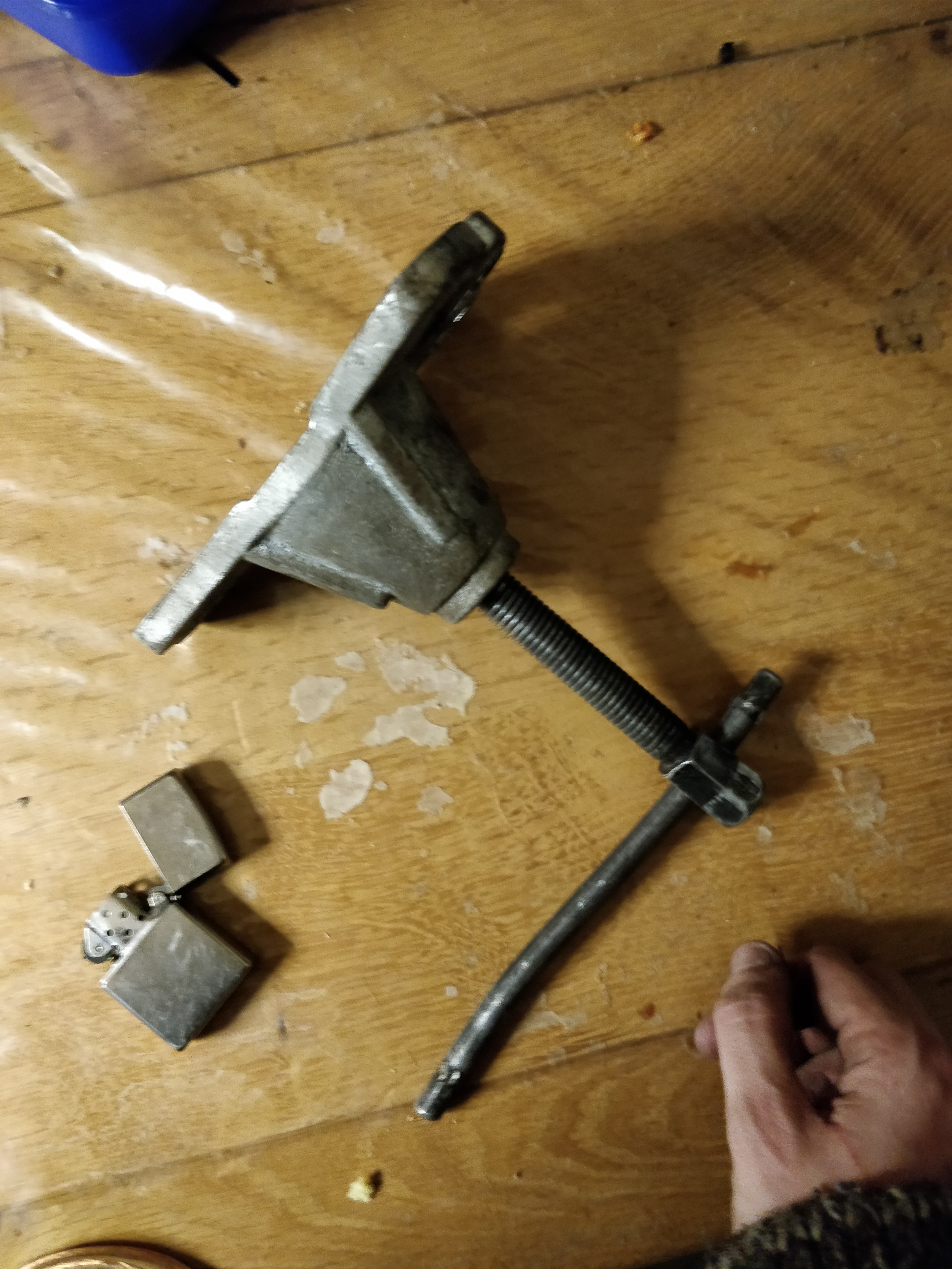

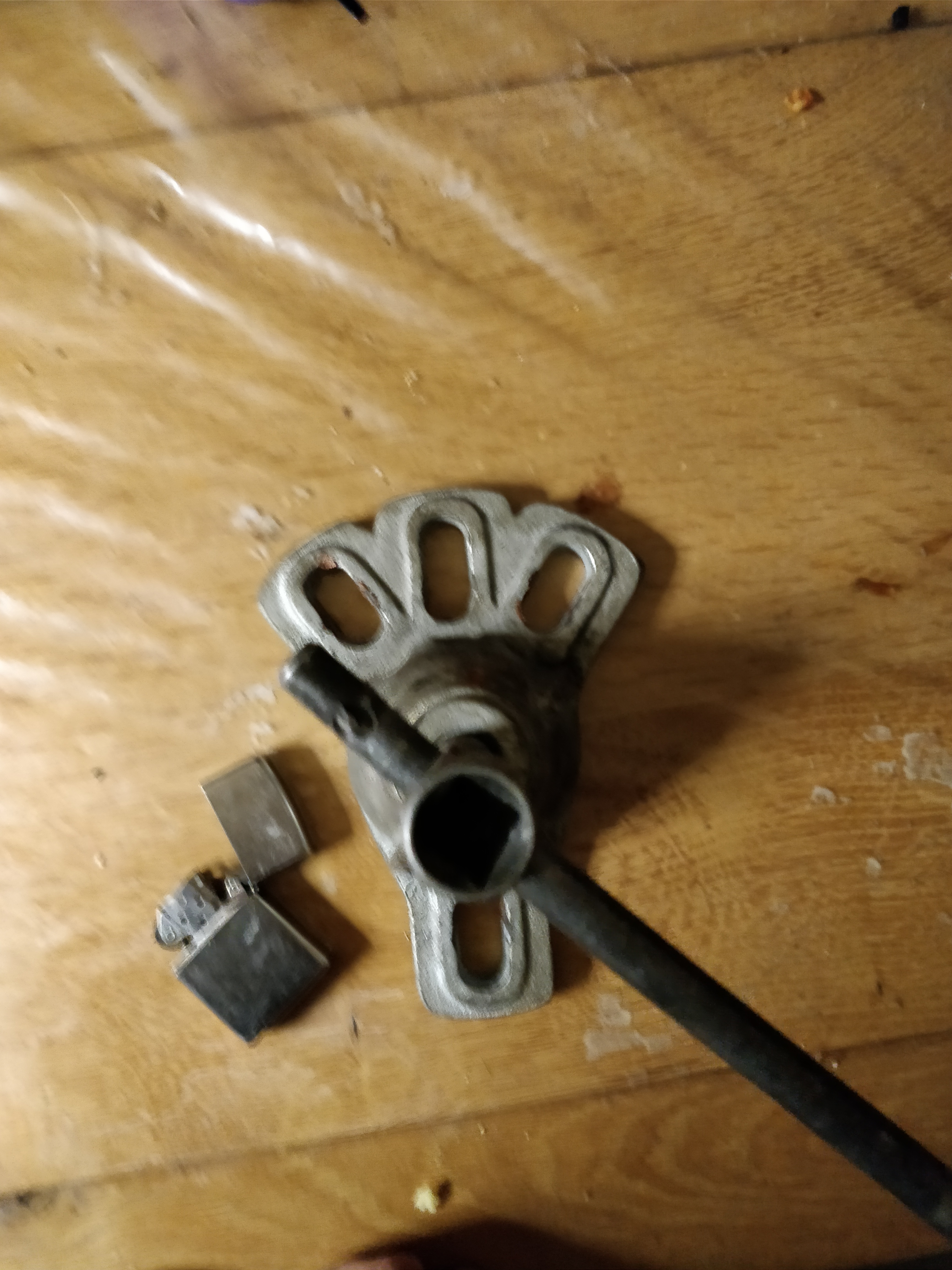

I've taken some pictures of the tool, it was bought to remove axles hubs.. it looks verry similair as one of the correct tools, but i'm not sure if it'll bolt on.. what you guys think?

Anything on the balancer to screw the bolts into??
