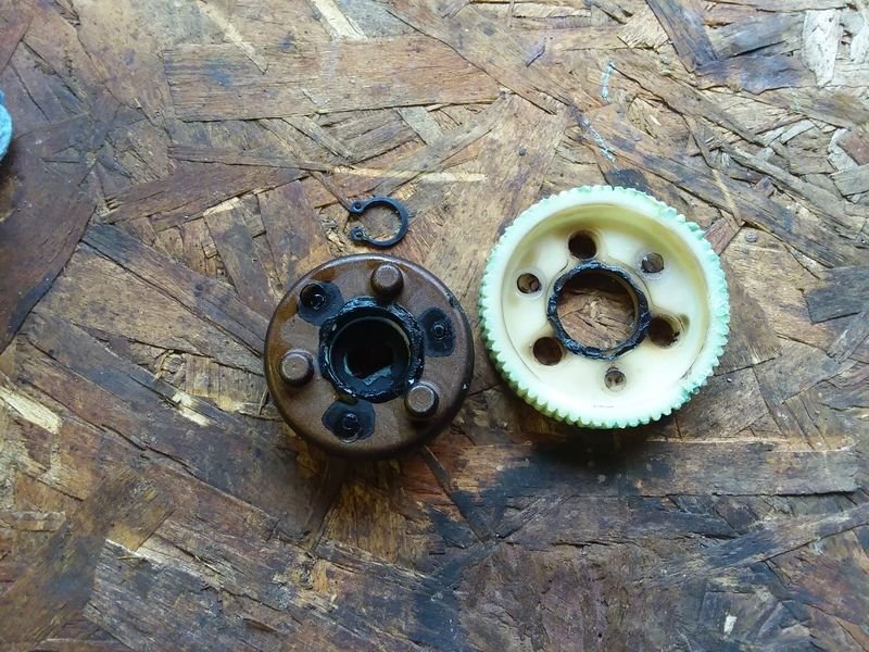

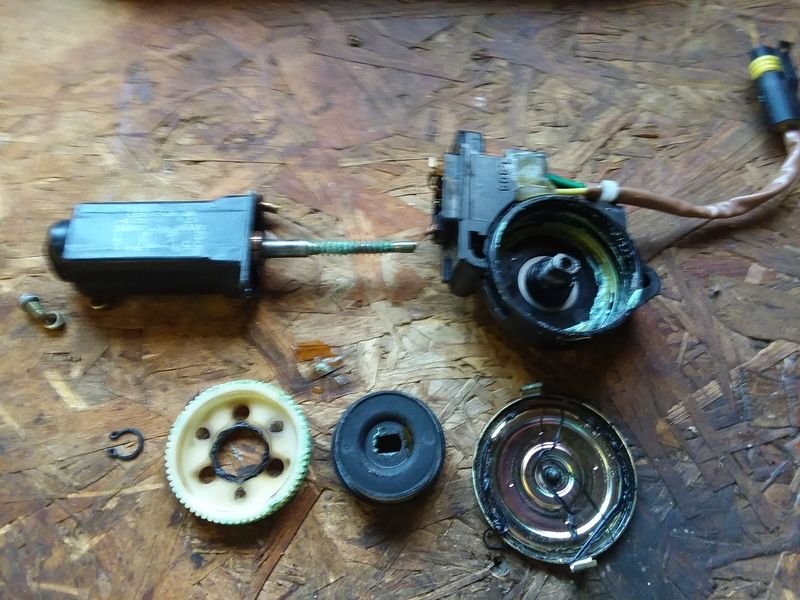

Hunter Kesler: You say when the motor is disconnected the window travels the path of the regulator. Is the motor functioning when activated after being disconnected from the regulator? If it is, then the issue is in the motor gear setup. Note the three plugs in this eBay image. Those disintegrate over time, but I don't know if the Dodge motors have them.

Here is the window motor gear assembly from my 96 Ram 1500
and here is just the driver and drive gear
No insert plugs/bushings as suggested by Gary-L
