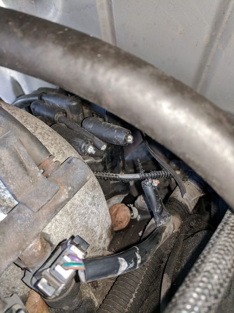

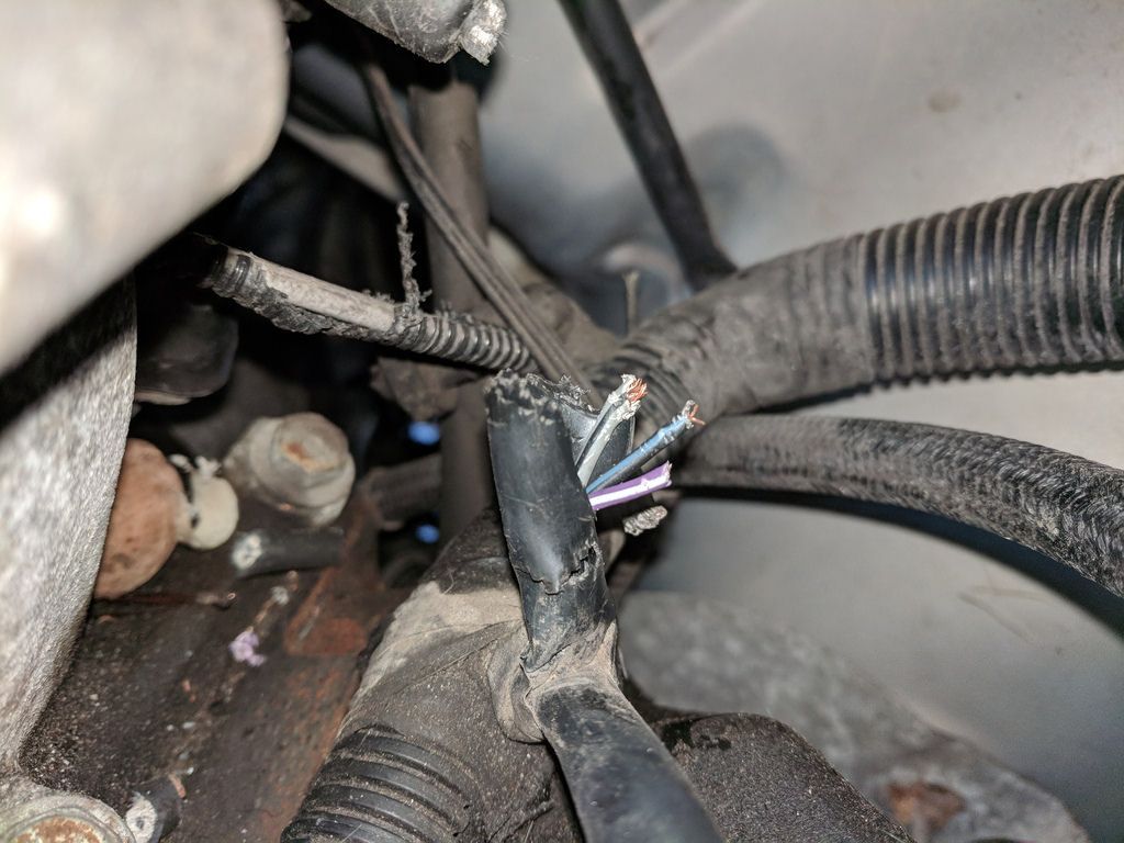

And... a few more...
They got me for 4 spark plug wires, the crank sensor... and something else - it's a grey connector near the drives side valve cover with 3 wires in a flat cable:
Any help ID'ing that connector above? I was able to pull/cut the loom around the small chewed off section coming off the engine harness and I believe it's where the crank sensor pigtail should connect:
Now I have to figure out how to lengthen that and repair it. Sigh.

Check the images above lol - no reason to check anything, I got rodent chew damage.
Anyone able to help with the purpose of that grey 3-wire flat cable connector in the third image?
Old Mar 11, 2018 | 04:58 PM
Posts: 87,479
How about a shot a bit further away. I don't recognize that one at all....
