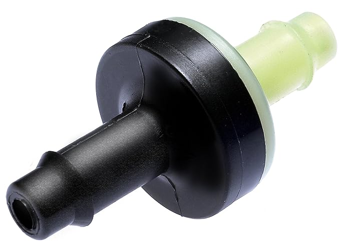

Or for just $14, you could have fixed the vents with OEM check valves:

Originally Posted by Ramman18
Good job on the work around!
You missed my point.
My problem isn't the check valves, it's the intake. All vacuum valves leak, some more than others. So you need a constant vac source, even with a check valve. When your source is intermittent, like mine, and many others, the blend doors go nuts. This gives you a reservoir of vacuum, for those times when you are hard on it, and your vac source disappears. Think of it as a car battery. Power in, power out, but when the power in stops, you still have a reserve of power out.
