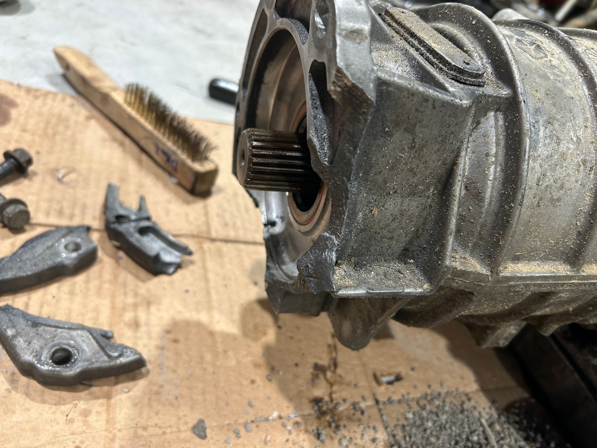

Don’t know if you have checked the mounting studs or the overdrive housing. I just pulled my transmission for a bad vibration and it was a broken overdrive housing where the t-case bolts up.

I can see how that might cause some problems......
