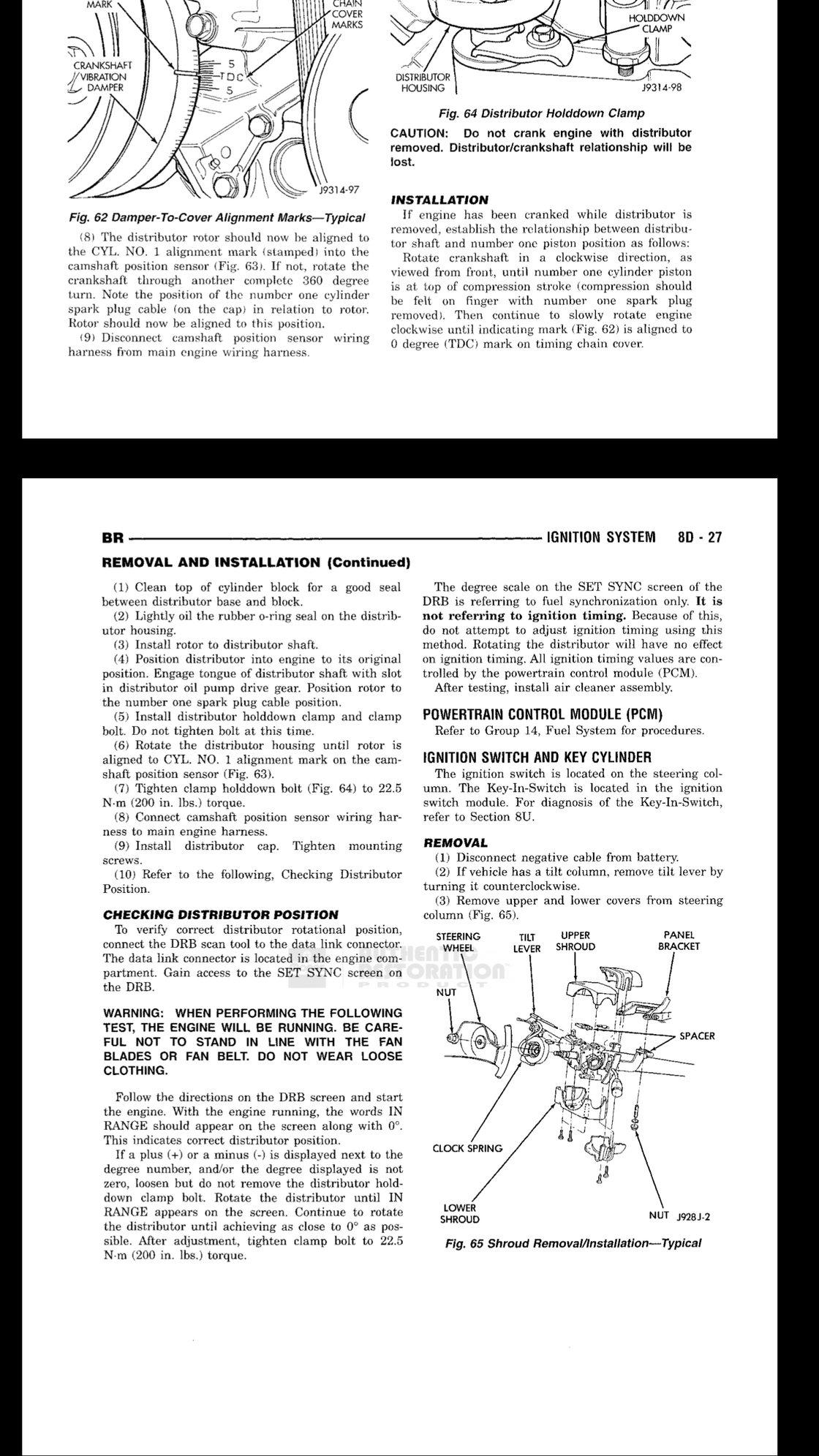

Just read my FSM you can only index the distributor which is what I told you about cylinder 1at top dead center and the rotor pointing to Cylinder 1 then you line up a notch on the distributor and that is called indexing the distributor. It should run from there and the PCM will adjust it. Unless the fuel sync is off which can only be set by a garage with a DRB scan tool.

Well Mopar thank you for the feedback. That's all kind of intimidating. I should be able to align tdc with the marks on the crankshaft. Then I can pull the distributor cap and see if it lines up with cylinder 1 mark and go from there.

I read through the diagrams. Does it make a difference if I never removed the distributor at all? And, is this the only way to correct the timing if the rotor is off?
