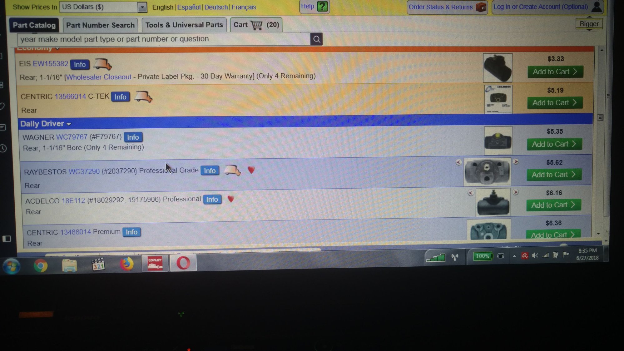

Wagner WC79767 1 1/16\" cylinder for $5.35 on Rock Auto
​​​​​​ I'll check on the shipping sometimes it's more expensive.
