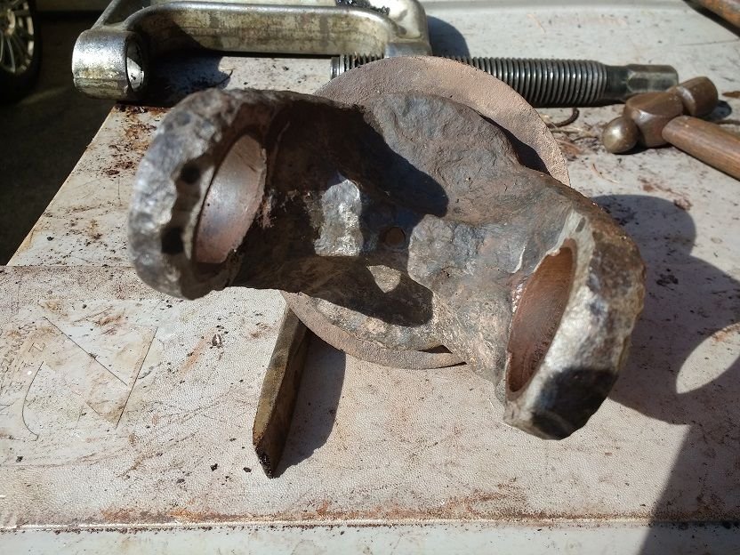

Got the left axle joint removed from the axles. Nothing visually wrong with it, looks fine. I don't think that one was my problem. I probably should get a wheelhub to reassemble, and the outer axle was pretty rusty - I'll have to get a picture. I'm thinking I need a different one.
Economical sources for that outer axle? 2000 Dodge Ram 2500 with dana 60 front axle.
I see Dennys will ship me one for $130.
