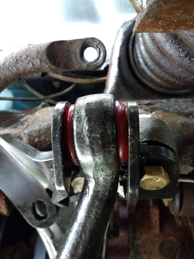

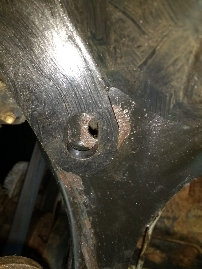

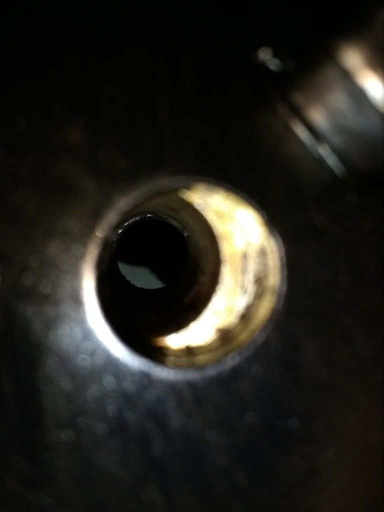

A couple problems, the damning one first. The track bar fits cocked in the bracket ears, so much so I will not be able to put the bolt through it. Second problem, the through bolt that goes in the cross member (middle bolt on the bracket) isn't even close to being lined up. I put a call into the number they have on the directions, and left a message.
The video of the SSI bracket that someone posted showed better hole alignment. And he was using an adjustable track bar, but he didn't show much of how the bushings fit in there for him. Pretty sure that the cocked position would wear out the bushing in short order and would probably restrict some normal and desired movement.
I could probably fabricate my way around the middle bolt by just welding the bracket on at that position. However the ears being the wrong angle with the track bar, pretty much has me convinced this bracket is going to be returned.

So pictures. First up is how the bracket doesn't match up with the hole in the frame gusset.
Second is how cocked the factory bar is in the bracket ears.
Third picture is another view of how cocked it is, looking at the back ear when the bushing sleeve is aligned with the front ear. Disappointing!
