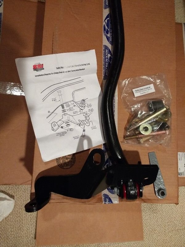

PDP sent me a USPS tracking number for the conversion bracket. Just checked tracking, its on the way? They must have had inventory. USPS says that package will arrive Friday. Hope its a bracket and not a mistake... If it is the bracket, I'll have a new track bar installed for the weekend ! Guess I better get going on that replacement steering box...

Energy bushings installed in the 3rd gen bar; not as trivial as you'd think. I have a large press, but instead I used a bench vise, part of a ram door hinge as backing for the bushing, a piece of conduit joiner (let the bushing slide through), and needed an extra set of hands to manage all the pieces while I basically struggled to jam 10lbs of crap in a 5 lb bag while trying to grab a greased pig. Drop anything with that grease on it, and you be dismayed to discover how sticky it is, how dirty your shop floor is, and how hard it is to remove stuff from that grease. The metal sleeves went in much easier, but still was a press fit. Should be nice and tight, hope that bracket locates the frame end of that bar properly so it centers my axle and is at the right angle so the bolts go straight through the sleeves. Still thinking about those risks... I'm thinking the bar gets bolted in tight on both ends, before the bracket gets fulled seated and tightened....

Bracket showed up today. Lota heft, really thick steel. I wouldn't be able to bend something up like that with my tooling. I guess its worth the $ that way. Didn't have much time, but got the axle end bolt of the 2nd gen track out. That track bar must have been in there a while, the cotter pin on the joint side is totally crusted in there. Spent a little time trying to see if I could just work it free, but it just kept breaking off. Not enough room to get the impact wrench in there, at least I don't think so. I'll muscle it off tomorrow afternoon and then start the installation.

Yeah, just double wrench it, and you can shear the cotter pin without too much effort.Looking forward to seeing how it turns out.
