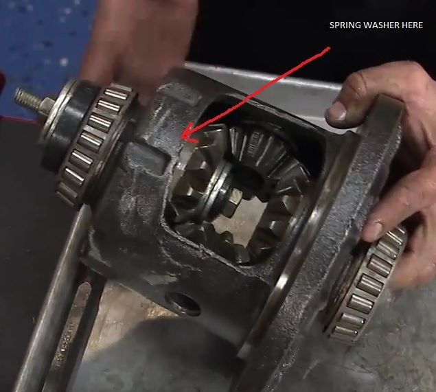

OK. Watched enough of that video to see that process would likely work for a trac-loc posi unit, but not a power-loc posi unit. The power-loc case is bolted together all the way around and has no large window in the case to allow for easy access of the clutches.

Well, the Ford has an easily accessible outer spring. The Dana 60 trackloc utilizes a belleville washer to apply clutch pressure, between the spider gear and clutchpac. The way everyone I've seen compress that is using a bolt/nut through where the axle would be, easy when the carrier is on the bench. Maybe a long threaded rod could work to compress the washer.... certainly very awkward, if you're by yourself. Hmmm... You guys are REALLY encouraging me to work this on my own... its like you don't like the service economy we live in...
Watch for a couple minutes if you don't know what I'm saying... Start at about 10:00 minutes in...
https://www.youtube.com/watch?v=oRJ9ukH9stA

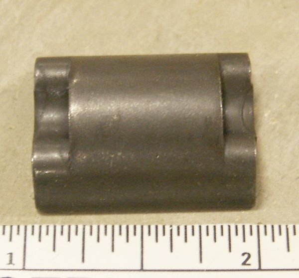

Yeah, the real problem hits when I find the carrier is screwed and now I have to tow it to the driveline guy... Maybe I'll pull the cover and try see what is going on in there. If its like my 04, and the dang clutch finger cilps are broken... grrrrr... stupid Dana corporation. First pic, the dang $2 clutch clip that break in the 3rd gen 1500s and can end up costing you a carrier, bearings and housing. After looking at the rebuild kits for this thing, I'm now really starting to think more seriously about a Detroit TruTrac....

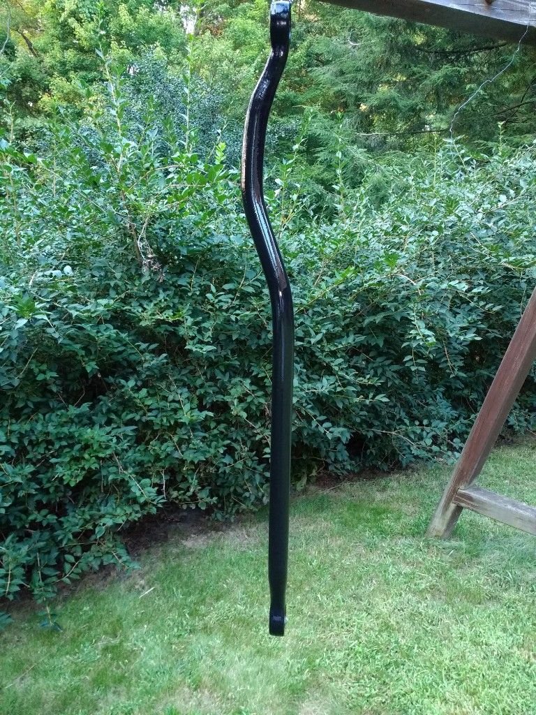

Second pic, in support of the thread subject - the painted 3rd gen track bar.
If I threw that bar in the grass near the sidewalk, I'd have at least one person in the household freak out thinking its a black snake Not that I'm thinking about doing that..maahhhahaa

Yeah, those clips are a problem on ALL the power loc diffs. Usually, the just break, and end up on the bottom of the pig. If you are really unlucky, that will take a trip thru the spiders, and REALLY foul things up.
That turned out pretty good.
So, whom did you scare the bejuzus out of?
