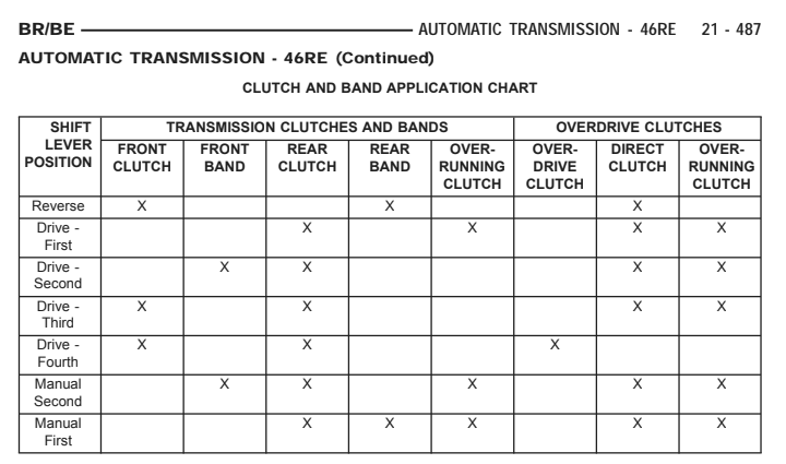

Old Oct 28, 2018 | 08:58 PM
Skeptic68W's Avatar
Skeptic68W
Joined: Jun 2014
Posts: 412
Likes: 26
Right there in the service manual is most likely my issue. Faulty overrunning clutch. **** me...
Ordered an OTC pressure testing kit to go through the testing procedure to be sure.
