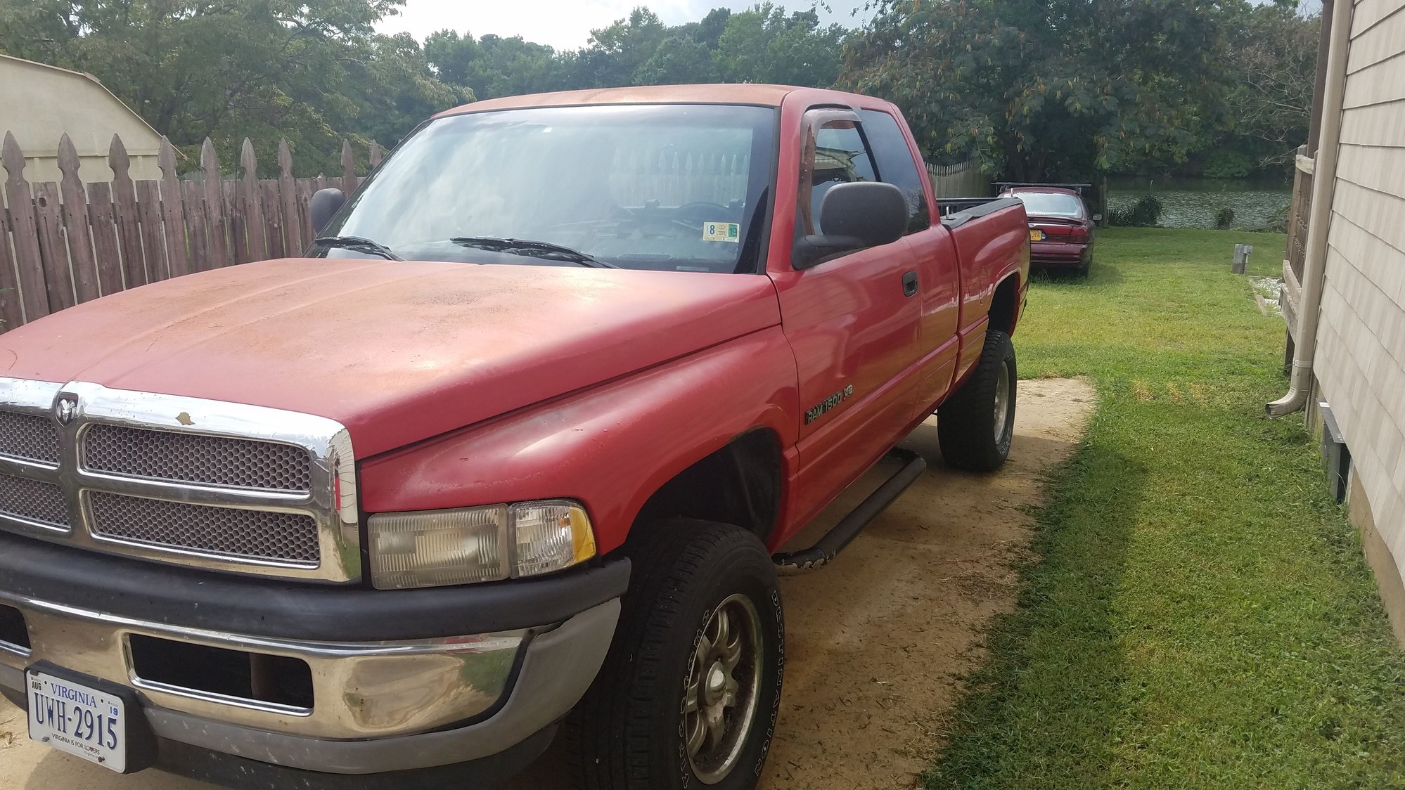

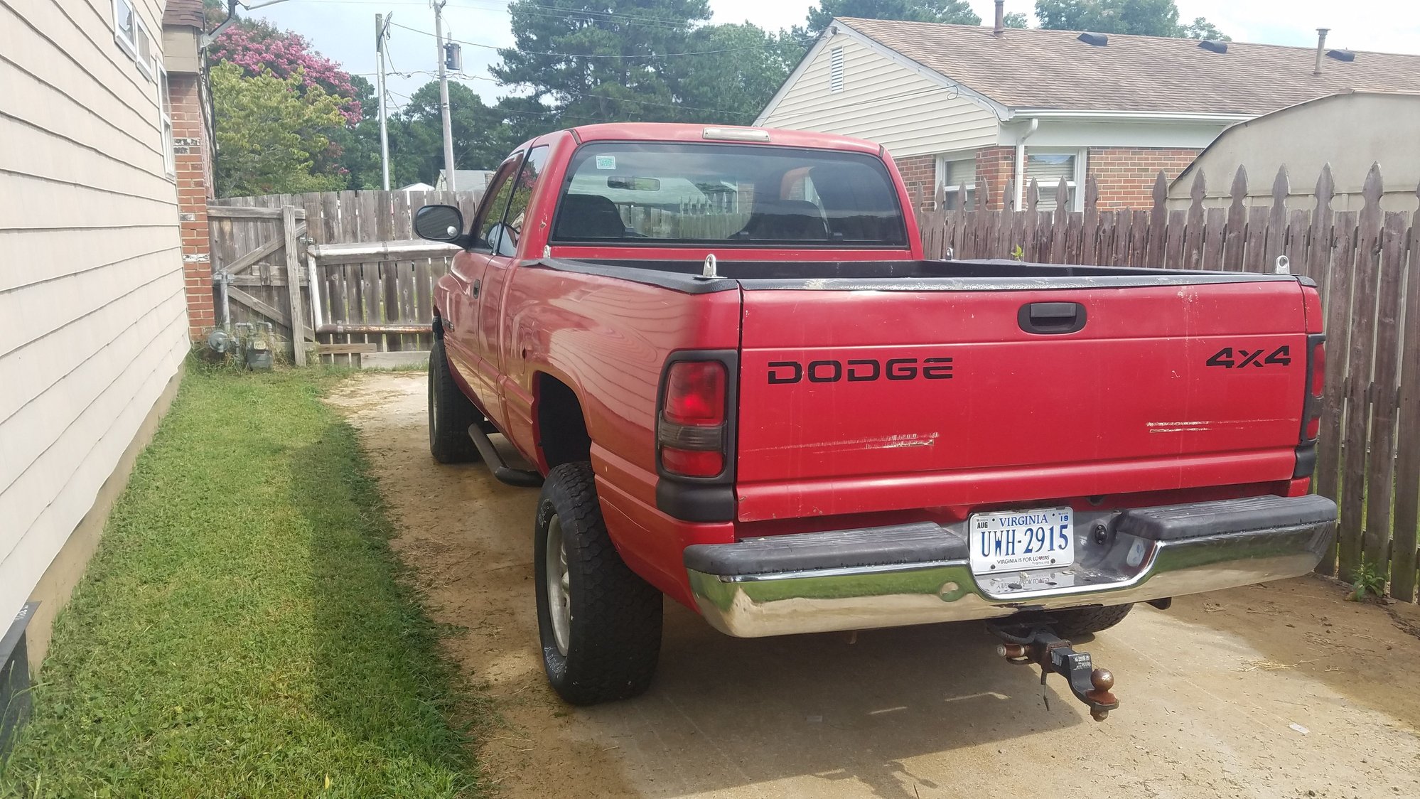

So, two days ago I bought a 2001 Ram 1500 4x4 with the 5.2. She comes with 170k on her, but is rust free other than a few places where the paint chipped off and has a small coat of surface rust. Overall, solid truck! I was able to get it for $1500, a complete steal! I test drove it pretty hard to make sure everything was good, paid the man, and drove home. The main purpose of this truck is to tow around my 78 Vette to car shows.
On the drive home, I just couldnt contain myself, and when I hit the highway, I put the pedal down to see what she was capable of... After a few moments, it hit what sounded like a rev limiter... (WHAAA WHAAA WHAAAA in rapid succession).. while it was doing this, the "Check Gauges" Light comes on, and I noticed my oil pressure dropped to zero .... S&*@... I limp it the rest of the way home, but it really drove fine other than some late shifts (around 3200 rpm before shifting). I double checked the oil, it was still full... checked the tranny fluid and it was running a bit low. My first thought was to do oil change, tranny fluid and filter change, and change the oil switch located behind the distributer... i have spent my day today doing that, started her back up, and oil pressure still showing zero... does this mean oil pump is bad, or what else can I try? Thankfully im in the green on this truck, so if i have to drop 500 to get the oil pump done, its not the end of the world. If it is the pump - should i get a high flow since im at 170k?
Thanks guys! Heres 2 photos I snapped quick before any sort of clean up.
